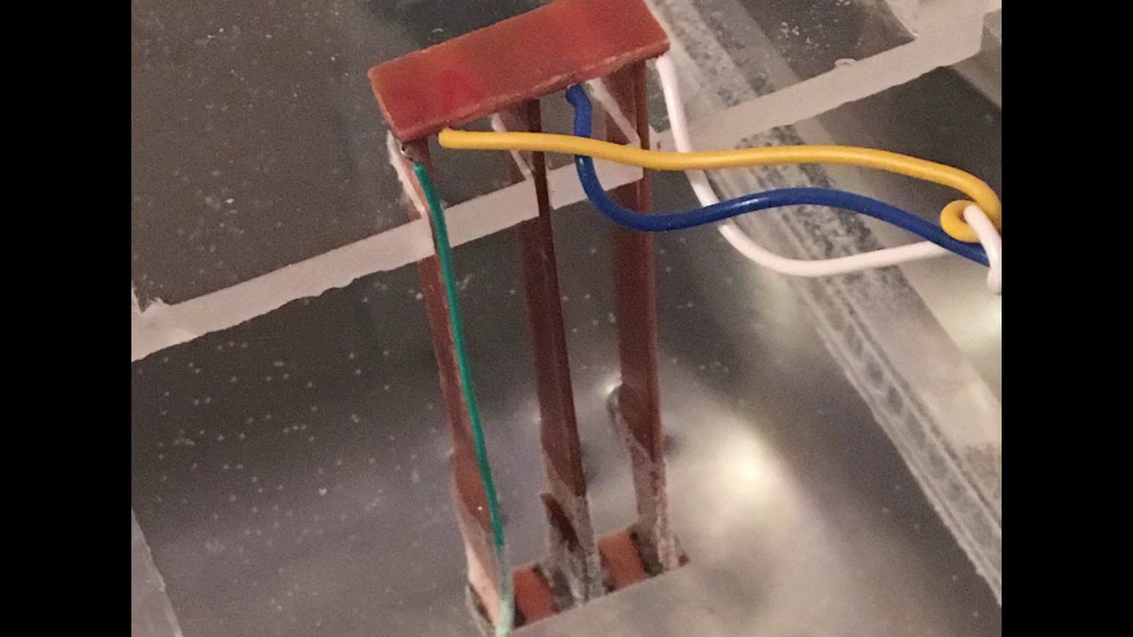

Evening all, beginner here. I followed a ocean wave model by a YouTube poster, who controls amplitude, frequency and pattern of the wave through three potentiometers, linked to a singular servo. I am struggling to source/generate a code which enables this to happen? Could any kind people provide a solution for this in terms of code please?

The only part not sufficiently described in the video is how the third knob controls the 'pattern' of the waves.
I would use four or six pots giving frequency and magnitude control over two or three separate waves. Turn the magnitude down to 0 for the waves you aren't using.

Hi John, these values as I understand it are to control, in Oceanographers language, wavelength (the horizontal distance between two crests or two troughs), amplitude (the vertical distance between trough and crest), and velocity (the speed at which wave crests move across the water). The Units of measurement for each is meters for wavelength and amplitude and meters per second for velocity...So I think I would take the 3rd control to the first of these, the wavelength. Would this still work?
The servo pushes the waveboard which suggests three things you can change: How fast it pushes, how often and how far. I suppose that the first gives amplitude, the second frequency and the last, pattern although I'm a little unclear about what pattern means in practice.
That ties back to the three pots. I'd be inclined to ignore them initially and just have the device generate one wave type and live with the fact that you have to recompile to change anything while you test out the mechanics.
Did you try contacting the author of the video - he might share his code, if indeed he hasn't published it already.
I think the third knob is controlling the difference in frequency between alternating wavefronts. It looks like when you turn that knob up you get alternating fast and slow waves.
