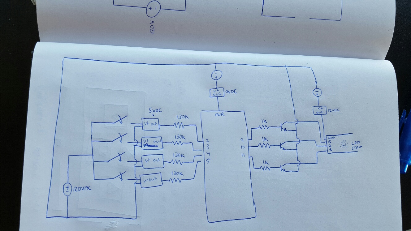

a schematic that i came up with for the inputs is attached as well

This is the moment you post a full circuit diagram of the setup :wink:
For example, I never talked about a pull up, only about a series resistor.
And, like I said, the touch switches do one press = on, second press = off, third = on etc. It toggles while a normal button is only on as long as you press it. Because the input is different you need different code :wink: Now you need to detect a state change. Every change from on to off, or from off to on is a single button press. Now when you detect that you do the same as what you now do when a button is pressed.

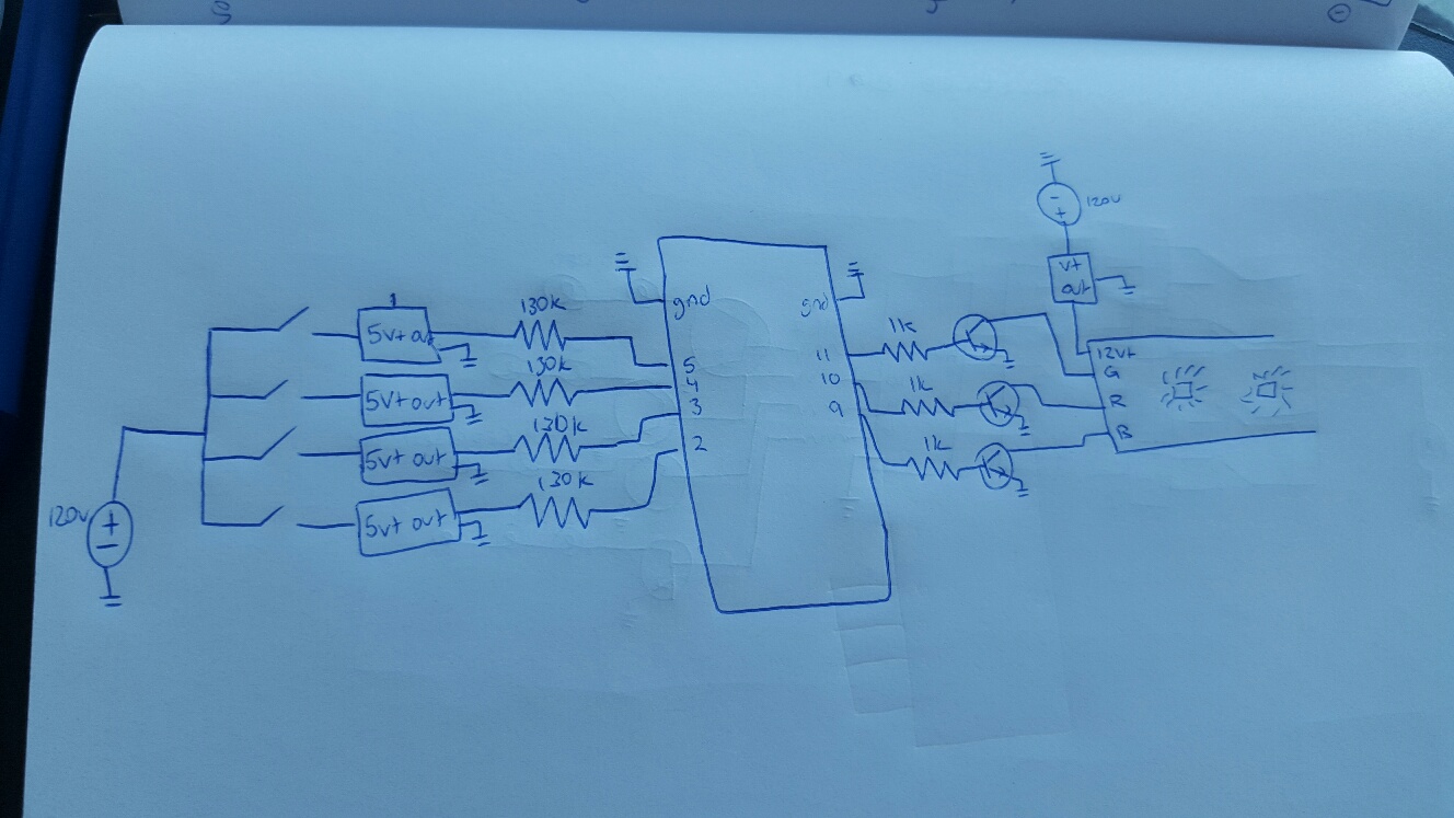

so below i attached what i have now, put the resistors back in series.. also attached my code based on putting together many other things from this forum that i had found on debouncing and state changes. on a side note my Arduino is now not being read by my computer either... this is a pain in the a$# project .. lol one thing leads to another.
multi_switch.ino (3.83 KB)
The circuit looks kind of okay. But what powers the Arduino? (Nothing is connected to it :wink: )
And I hope you just made a drawing error and the other side of the mains (120V Neutral) isn't connected to GND... And I think the USB chargers have a Neutral connection as well. Mains and low voltage for the Arduino and leds should be completely separate. Can you confirm this is a drawing error and redraw the circuit?
Then off to the code. First thing I notice you try to do a debounce. Aside from the code for that isn't right I don't think you'll need it. The chargers are "slow" devices and I don't think they have bounce (but in a worst case they might).

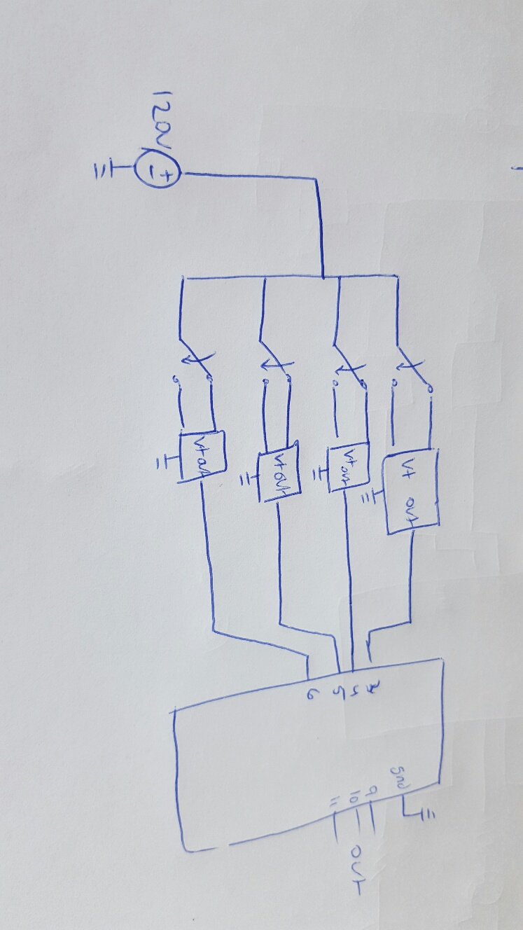

Yea the schematic was just a quick sketch those grounds are a quick mental note saying they connect at the same node to the mains neutral, my fault. The Arduino will be powered by a 9VDC adapter but most of the time it is running the code while plugged into my computer so i can make quick edits to code, and obviously unplug if i need to make changes to circuitry.
to be more accurate i have another schematic that is attached and this is exactly how my circuit is hooked up currently.

RyansProjects:
Close but no... Because now non of the low voltage parts have a GND, the 9V and 12V adapter don't have a neutral and where did you get the multiple 120V sources from? :wink: I know it's nitpicking but how often we come across a problem where the problem is in the details. Also, making good documentation is a joy when you start to work on this in a couple of months etc. So give it one more try :slight_smile:
But I think (but don't know for sure) the connection part is alright. But like I said, the debounce part is just wrong and you can probably just leave it out because I don't expect an USB charger to bounce.
