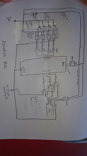

i would like the colours of the LED strip to change even when the switch goes to LOW and not just on HIGH. my circuit is also attached
Your schematic and code are confusing... It looks like you have 120VAC connected to a 5V Arduino. What are you trying to do? Is there a reason you're using 120VAC on the switches?
I guess those 5 boxes between the AC switches and the Arduino are 5V DC power supplies? If so, you don't need the 130K resistors.
And i guess these are existing AC switches, and that's why you are using AC switches i this project?
I think you're probably stuck in a while() loop...
i.e. How can you ever get past the red switch loop until you change the red switch?
Add some serial.Print() statements and use the serial monitor so you can "see" what your program is doing. The serial monitor is your best debugging tool.

the boxes are USB chargers, the USB plug was spliced and the 5V wires are connected to the ardiuno pins via 130k resistors. The ground wires are connected to the transistor and arduino grounds. The switches are 120VAC because the end project will be using touch switches that are on the wall powered only by mains.

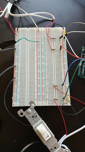

below is a picture of my input. All the wires on the left + are the switch hot wires, each switch is directly connected to an individual USB charger + prong and the - prongs are all joined into that green wire and plugged into AC neutral. The red wires on the right breadboard are the 5V+ from the USB chargers. they pass through a 130k resistor to a respective coloured wire that goes into the arduino (RGBW) the arduino and USB chargers share a common ground.

I'm still lost... You need to explain what you are trying to do overall. It sounds like you want to flip a light switch on the wall and have an LED strip turn on and off.
its for an application in a hospital setting for a small project. there will be a constant emitted white LED until one switch is flipped then the lights will change to that switches designated colour. While that switch is on another can be pressed, changing the lights to that switches designated colour now. if i pressed the previous switch again it would change back to that colour. etc and on and on. the switches will be touch switches in the end that are 3-way switches, if that changes anything. the last button pressed will be that designated light.

I would not use USB adapters as your input source to the Arduino. A relay with a 120VAC coil makes a better choice. Power supplies do not like to be cycled on / off, relays are designed specifically for that.
