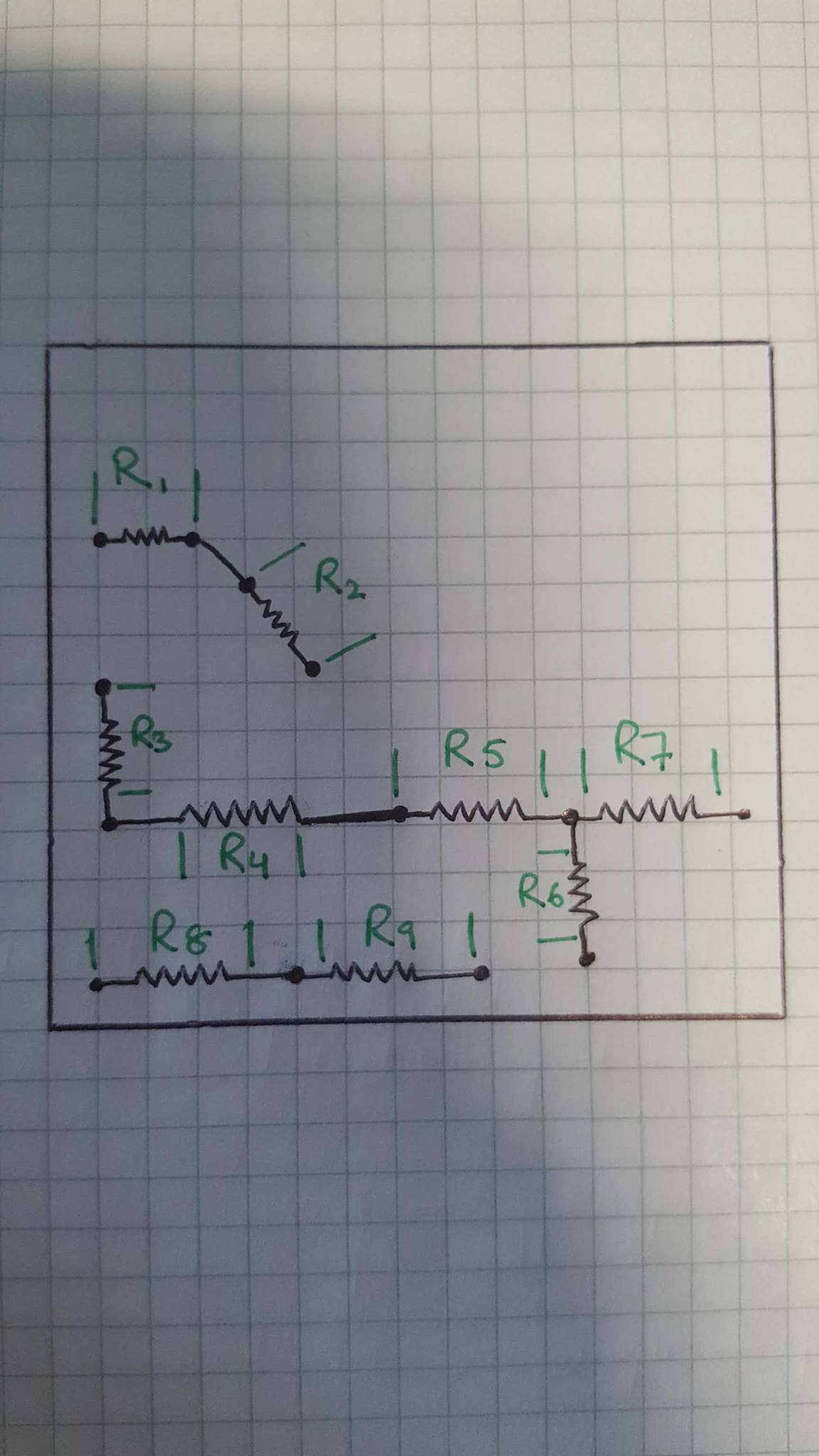

i am a new user of arduino uno. I want to know how can i calculate the value of unknown resistances using multiple analogue inputs by an arduino.
and the main point is every resistance is unknown. I have also attached the Picture from which you can get an idea.
if any one can help me in this matter?
You can't - analog inputs are reference to ground , so all
Analog measurements have to be with respect to ground ( 0v) - you can't have " floating inputs". Why do you want to do this ? What are you really trying to do ?
i am working on integrated circuits. so i have to measure resistance between each leg of IC.
OPs posted circuit

If you connect one end of those resistor networks to GND and one end to 5V and analog inputs on the nodes, you should be able to calculate the in-between resistances as it's simply a voltage divider. Just make sure it's all linear, so the branched ones need multiple tests.
But then if it's an IC as you later reveal, the whole picture changes dramatically. Whether that is even possible depends on the IC itself. If it's a semiconductor it becomes even trickier - a diode for example has a voltage drop but no resistance: under it's threshold voltage the resistance is infinite, above that it's zero (for an idealised diode, of course, real world ones have leakage and a small resistance).

Well, if you can indeed approximate as a series of resistors, it's still simply a matter of connecting one end of the series to Vcc and the other end to GND (add an extra resistor on both ends) and then connect all the mid points to analog pins, and calculate the resistance from there. Then it becomes rather straightforward, just a voltage divider.
Of course you can only do as many pins as you have analog inputs, which is not that many, so doing it manually is probably just as fast (shouldn't take more than a few seconds for each adjacent pair of pins).

If this is really an IC then measuring resistance with no power applied will look like diodes to ground. Measuring the resistance with power on the IC is meaningless. Measuring the impedance is another matter.
