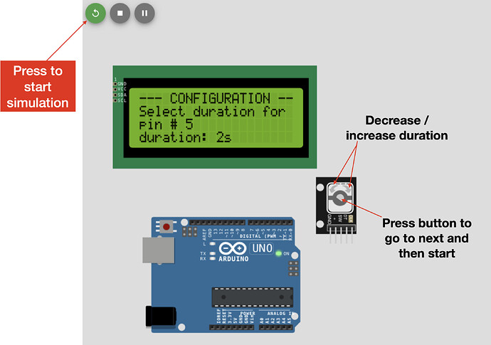

I have a programming feasibility question regarding a potential project.
The project would be a relay sequencer that can be configured without adjusting and re uploading the sketch. One input to start the sequence and relays triggered individually after a set time.
My first thought was to have a pot mapped to 10 seconds and use this value to determine the delay for the output pin but this would mean one pot per output pin. So my question is would it be feasible to somehow select an output pin, record the pot value and assign it and then move on to another output pin assign a different value from the pot and so on?
I am a complete novice with programming so please forgive the lack of specifics, I'm just trying to see if its achievable before I start with the blood, sweat and tears

It's feasible.
You could use one push button to select the output pin and another as a"store the value" button.
You will need some kind of display to show which output pin is selected.
use a rotary encoder (KY-040 style) and the encoder library. They also embed a push button (use the Toggle Button library from @dlloyd) so that you could use that to signal you want to go to the next pin
are you suggesting that the pot value be recorded when a button is pressed and that multiple values are stored in an array which is used later, possibly after a 2nd button is pressed?
How will you know where the pot is set (1 to 10)?
Sure, that's that's possible - but very cumbersome for the user!
You could combine that onto just one button to do "store & select next".
Re-inventing the terrible UI of early VCRs ... :scream:

I'll explain the project a little further in an ideal world I'd have an lcd display with a few buttons (output select, store, value select and value up & down) where the user could define the starting position of the relay (open or closed) straight high or low activation or pulse with an adjustable duration and then a delay from initial start input.
However my idea is vastly ahead of my coding so I dumbed it down as much as I could (hence the pots) so I had a fighting chance of getting it to work.
I guess the road block for me was looking at the coding and not seeing a way in which the code wouldn't just see the current pot value and apply that.
So from what everyone is saying it is possible to adjust and store values inside a sketch from a combination of buttons, lcd, pots or whatever?
Absolutely!
That's pretty much what all code boils down to: reading some inputs; doing some stuff with the values read; setting some outputs correspondingly.

sure here is an example (10 minute work) leveraging existing libraries
everything is hard coded and sequential, so this is just a proof of concept but then the sky is the limit
I mean wow, yeah exactly the sort of thing.

yeah if you code correctly you can easily go below the 10th of millisecond. of course you would not handle the loop as I did
(added LEDs so that the sequence can be visible)
we would say just "Tout est possible" :slight_smile:
