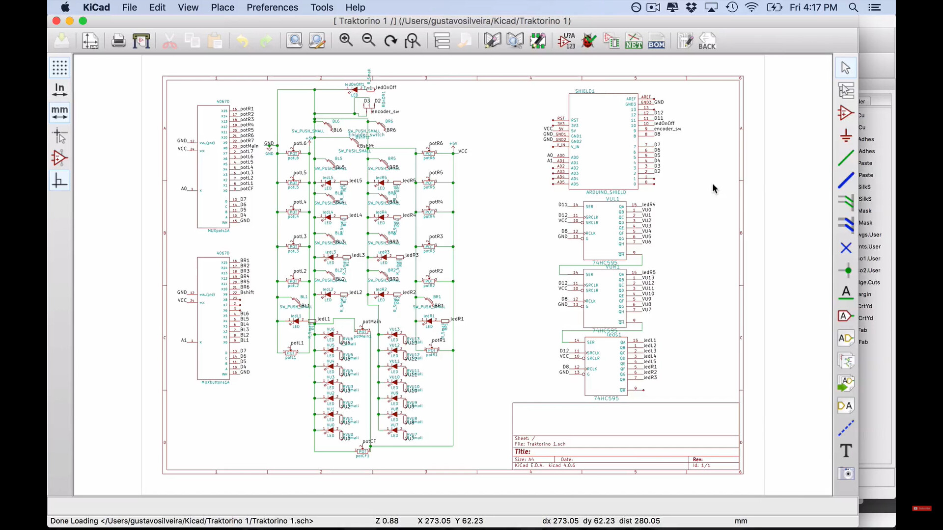

so i did a lot of read, and manage to add one more hc4067 and send midi note, (code is writen to have 2 hc4067)
and here is where i need you help. can some one add me a few lines to my code so the thirt HC4067 CAN handle 2 or 3 encoders?
THANK YOU SO MUTCH for you help and time
Traktorino.ino (21 KB)
this is my schematic and how is connected all, just is missing the third HC4067

I am not sure if it will be possible to attach encoders to a 4067. Encoders require a fast response from the Arduino, otherwise signal edges will be lost, and the encoder will appear to "slip" or even appear to be moving in the wrong direction. With the encoders attached to the 4067 it will only be possible to "poll" the encoders pins at a relatively slow rate. It is best to attach the encoders directly to Arduino pins.
You are not using pins A2 to A5? Could you use those for your encoders?
hmm sound good, i didnt know that i can use A0-A5 for encoder, i thought those pins was only for analoque inputs and not digital.
and how i can do that my friend Paulrb?? like i said i have no idea about programing, very few thinks i know.
Yes, A0 to A5 can be used as digital inputs or outputs as well as analog inputs.
Is your code short enough to include in your post, between code tags? I cannot open .ino attachments on my phone.
I can see that the encoder you have now is connected to D2 & D3. These pins have interrupt capability, and they are the only such pins on Uno. Using other pins as digital inputs for the encoders may still result in some problems and not work as well as the encoder on pins D2/3. You may need to use the "pin change interrupt" feature to enable interrupts on pins other than D2/3.

The encoder library you are using is this one from PJRC.
That page says that if you do not use interrupt pins, the performance will be low. A2 to A5 are not interrupt pins. The library does not offer the possibility to use "pin change interrupts".
Do you still want to connect these encoders, with low performance?

i will use pins A2 TO A5 they will send a midi note and if there is a small misreading, is not a big deal
they encoder on those pins will control the PITCH of a song,
This code does nothing else except monitor one encoder. That may be why it seems to work well. Once added to your big sketch, which performs many other operations, the performance may not be as good. There is only one way to find out...
How would 2 encoders be used to control pitch?
What MIDI commands would be needed to change the pitch? Can you find other example code which controls pitch?
encoder on pin A2 -A3 will control the (pitch (jog wheel turn) on deck A and encoder on pins A4-A5 will control pitch (jog wheel turn) for deck B.. pins A2-A3 will send o midi note ex. ch5.cc.005 on one direction and ch5.cc.004 on the other direction. A4-A5 will send ch5.cc003 AND ch5.cc.002. it doesn't matter what cc note will send it can be any, inside tractor dj software, i will map pitch at those cc note and address it for pitch.
