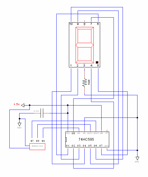

After having experimented with all manner of displaying digits on a 7 Seg display and eventually realising that none of them were actually multiplexed, I have cobbled together a few codes written by other people. I had seen some demonstrations where people had started the multiplexing with a noticeable delay between individual segment displays and then progressively reducing the delay until it was inperceivable and thus displaying a steady digit. I have altered the delay function so now it decreases to a certain point but then goes back to the initial delay period. I can see why it does this but I cannot work out how to get the delay period short enough to allow for the steady digit display I am aiming for. Can anyone please offer me a gentle nudge in the required direction :smiley:

How is the hardware for this connected up?
Here is the circuit CR. I realise that I could use common anode display with TPIC6B595 but I am interested in using this hardware setup purely to try and gain a fuller understanding of the coding required to multiplex via this hardware. I have tried other methods such as DPM and directly from the Arduino pins as explained in one of my previous questions here
Edit - attached correct circuit diagram 21 Sep 2013
  1. VCC is not connected to 5V. Fix that, with the 0.1uF cap from the Vcc pin to Gnd.
  2. MR is not connected to 5V. Fix that. It does not need a cap.
  3. OE/ is connected to Gnd, that's ok. Could connect to a PWM output pin for brightness control.
  4. This appears to be a common cathode display, with a single current limit resistor.
    Your plan is to drive 1 segment high at a time so that the illumination level stays consistent?
    (5V - 2.2V)/220 = 12mA assuming typical Red display.
    Each segment on 1/7 of the time, so that will appear dimmer.
Whole point of this exercise is to save 6 resistors?
I would go at it like this with this setup and assumed operation of #4.

Thanks CR. I don't know what I was thinking when I drew this circuit diagram in my lunch break at work today :grin: I can assure you that I do not actually have it connected up as such. I keep putting caps on the MR pin because I was under the misapprehension that both VCC and MR should have them, so I will remove the cap on MR. I am not wealthy but I can afford a few 220 ? resistors, I am only doing it this way to try and improve my rudimentary coding knowledge. I will have a look at your suggestions and see how I go. Thanks a lot for your help ... again.
