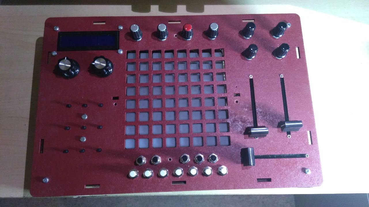

I am currently building a MIDI controller and I have written the code for its various parts separately.
The controller has 23 buttons, 11 potentiometers, two encoders, one I2C LCD screen 16x2 and a 2x2 trellix matrix from adafruit also I2C - here is the link :
https://learn.adafruit.com/assets/17311

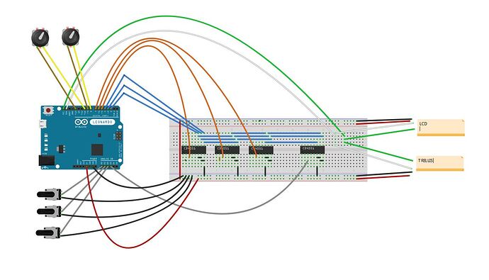

I have attached a pic of the controller (and connections) which I have now assembled.

Please post a proper schematic. Hand drawn is ok, and 100 times better than what you just posted, which, frankly, looks like nonsense. Your pots are connected to your digital inputs and your buttons are connected to your analog inputs? Please review and correct.
Please see the attached file with proper schematics. Pots are connected to A0, A1 and A2. The pots on the multiplexers are read on Pin A3. Buttons are all connected to the multiplexers and the values are read on pin 5, 6 and 7.
Clearly all buttons are also connected to ground and pots 1 to 8 also connected to ground and 5v.
I hope it makes more sense now.
(sorry I just realised I made a mistake when drawing the schematics (the SCL and SDA are inverted )
Ok, that makes much more sense now, thankyou.
I can't see any reason for the symptoms you described in your original post, looking at that schematic. Please post your complete code. Use code tags.
