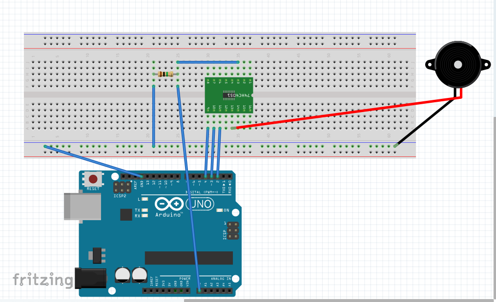

I have bought the 4051 multiplexer for my arduino project. I want to read from multiple analog inputs (coming from piezo discs), but am having trouble wading through the process of understanding the code, as I am mostly a virgin when it comes to programming. I'd like to have the multiplexer cycling through all 8 pins constantly, while prepending an alphabetical letter to each reading in order to identify which pin it came from.
I am using an adaption of the code supplied at Arduino Playground - HomePage and the code supplied at http://www.arduino.cc/en/Tutorial/Knock. Attached is the full code I am currently in the process of using, but am confused about the following section:

That was quite the reply! Its really encouraging to see how much length people are willing to go to to introduce newcomers :slight_smile:
I hope you don't think I'm lazy/stupid or anything because I didn't know about datasheets. I know very little about circuitry, so I just... well, didn't know what they were or that they existed tbh, and therefore didn't know I was missing information that should have been supplied! Just wanted to point that out cuz I don't want to come off as a boy that expects everything handed to him on a silver platter. I did also do my research on the code terms, components, and circuitry terms. Sometimes having the same thing explained to you in a different way can communicate better, and I think you achieved that! While I already grasped the functionality and ins-outs of the de/multiplexers etc, your dissection of the bitread code section lead me to the eureaka moment, so immense thank yous!!
I wanted to prepend a letter to the end of the readings because I wanted to send them to Max/MSP (graphic surface coding environment for MIDI/A/V), where the readings could then be routed by their prepended letters in such a way that pin y0-y7 would all be treated differently and appropriately. I found out how now. Below is my roundabout way of writing the code before reading your replies, with the alphabetical addition at the end!

Ok, so I have the code working now. I've adapted it to read just one pin for the moment (y0). However, it seems that I am somehow still able to read every pin at once, which is obviously not possible right?!! I think my piezos are sending out too think a voltage, so I thought I'd use the 5V out from the arduino instead.
If I apply 5V to each input pin, I get a high reading for each one, even though I haven't changed what the address lines of the S0,S1 or S2 inputs.
It is the CD4051BE multiplexer. I've attached the datasheet, my arduino code, and my layout. Can anyone spot what the problem is? Hope I'm not being really thick now. I'm wondering if the components are just cheap and ineffective...
Piezo, Arduino, Multiplexer.fzz (4.15 KB)
Multiplexer_test_singlepin.ino (1.15 KB)
CD4051B multiplexer datasheet (1.05 MB)
In your image, check what should be connected to pins 16, 7, 8, 6
Ok. Let's review what we know so far. You some code that count from 0 to 8 in binary and the variables that represent bits 0,1,& 2
are used to control the address lines of the multiplexer. For the benefit of the readers who haven't noticed you chopped off part of the code in your initial post, let's show them what you started with:

So now you are simply setting the address lines to the binary address B000, and reading the sensor. (based on code posted in your last post.)
I don't know what you think you are doing here but if you want to test the multiplexer input you need to ground inputs 1-7 while applying 5V to input 0. Then change it to ground all but input 1 to which you apply 5V. Since you removed the addressing code that increments the address lines you will not be able to measure anything on inputs 1-7 because you are selecting line 0 with
all the address lines LOW.
I have no idea what this means :
This is driving me craaaaazy!
Can you elaborate ? What seems to be the problem ?
You chopped off the file extension for the datasheet.
I thought you said you were going to read the datasheet ?
How come the chip has NO POWER ! (NOTHING CONNECTED TO Vcc,Vdd,Vee) ? (pins 7,8, & 16)
That's what I said, and pin 6.
