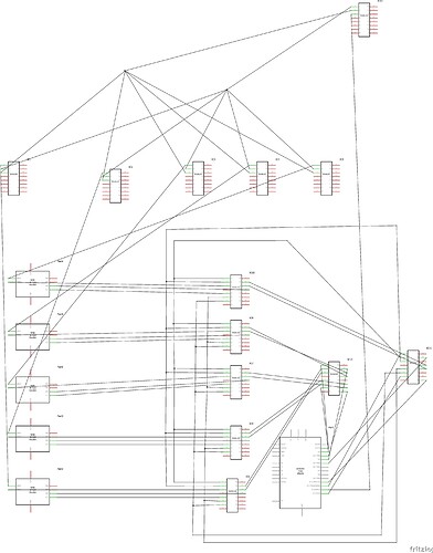

I got 5 MFRC55 (RFID) reader. When I hook them up together I get a lot of noise on the line. Sometimes it works and sometimes it doesn't.
So it's suggested to use multiplexing on the line. I quote:
"The solution is to use multiplexers for each arduino pin: SCK, MOSI, MISO, then bring every card's SDA pin to GND so they are all selected. Then you initiate just one class object, and start it for each card in turn. That way you can have as many RFID readers in communication as you want, limited only by the multiplexers. "
So I tried that.
I attached a CD4051 Multiplexer on one line. In this case the SCK line and tried to attach 1 reader. It failt. The Arduino does not see the RFID reader. So I am a bit stuck here.
- I connected the SCK line to port 0 on the CD4051.
- If I replace the RFID line on the multiplexer with a LED, the LED works fine. So the multiplexer is connected in the way it should be.
- I can get the RFID to work connected directly to the Arduino.
I feel like i'm close to getting it to work, but I am a bit stuck on what to try next.

#include <SPI.h>
#include <MFRC522.h>
#define RST_PIN 9 // Configurable, see typical pin layout above
#define SS_PIN 53 // Configurable, see typical pin layout above
int addressA = 1;
int addressB = 2;
int addressC = 3;
int A = 0; //Address pin A
int B = 0; //Address pin B
int C = 0; //Address pin C
MFRC522 mfrc522(SS_PIN, RST_PIN); // Create MFRC522 instance
Serial.begin(9600); // Initialize serial communications with the PC
while (!Serial); // Do nothing if no serial port is opened (added for Arduinos based on ATMEGA32U4)
pinMode(addressA, OUTPUT);
pinMode(addressB, OUTPUT);
pinMode(addressC, OUTPUT);
multiplex();
SPI.begin(); // Init SPI bus
mfrc522.PCD_Init(); // Init MFRC522
mfrc522.PCD_DumpVersionToSerial(); // Show details of PCD - MFRC522 Card Reader details
Serial.println(F("Scan PICC to see UID, SAK, type, and data blocks..."));
multiplex();
// Look for new cards
if ( ! mfrc522.PICC_IsNewCardPresent()) {
return;
// Select one of the cards
if ( ! mfrc522.PICC_ReadCardSerial()) {
return;
// Dump debug info about the card; PICC_HaltA() is automatically called
mfrc522.PICC_DumpToSerial(&(mfrc522.uid));
void multiplex()
A = bitRead(0,0); //Take first bit from binary value of i channel.
B = bitRead(0,1); //Take second bit from binary value of i channel.
C = bitRead(0,2); //Take third bit from value of i channel.
//Write address to mux
digitalWrite(addressA, A);
digitalWrite(addressB, B);
digitalWrite(addressC, C);
//digitalWrite(outputpin2, 1);
