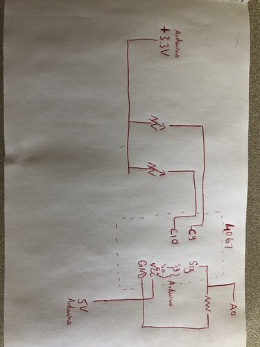

I'm working on my first arduino project for work where I am trying to build a temperature probe with each thermistor read and saved with an arduino. I'm a biologist so my electric engineering knowledge is very limited but very happy to learn.
For now, I would like to use 8 thermistors with only one reference resistor (they are too expensive to buy one for each thermistor). I have the 4067 multiplexer but I am struggling to figure out how to connect everything so it does what I want it to do.
I've attached a picture of how I've wired everything. I'm not sure how the current flows through the multiplexer and would greatly appreciate some help with this.
My logic behind connecting it the way I did was:
Current starts at 3.3V goes through thermistor C9 (selected in code) through multiplexer to Sig which is connected to the resistor and A0, hopefully creating a voltage divider. Resistor is connected to ground on multiplexer.
Multiplexer gets power from the 5V arduino pin. Does that work? Or should that also be the 3.3V?

OP’s schematic:
That should work.
“one reference resistor (they are too expensive to buy one for each thermistor)”
Not that expensive.
However, each thermistor can have its own ground resistor, you would multiplex the divider voltages instead.

Your thermistors will not be exactly the same so why you need a precision resistor?
What temperature range do you need to measure?
There might be a issue with you design:
The 4067 is not an ideal switch, but has a resistance around 60ohm (It varies a bit) that will be added to the thermistors resistance, reducing you precision. How much depends on the resistance range of you thermistors.
The ADC on a Arduino is not very precise with only 10 bits.
You precision will also be depend of how stable the 3.3V output is compared to the 5V or the internal Arduino reference.
If you need such expensive resistor it is probably you want it very precise. I think this will not work!
  1. The 4067 have some ON resistance - about 200 Ohm IIRC. The resistance changes slightly with applied voltage, supply voltage, temperature...
  2. Arduino's ADC is not precise enough. If you need anything better than 1% resistor you need better ADC.
Possible fix is taking 1% resistor and calibrating the whole thing?
Also you don't need a multiplexer for this. Connect thermistor to Arduino's pins. Turn one as OUTPUT HIGH and other as INPUT and it will be as if it the one were connected to 5V and the others disconnected.
Why you want to connect them to 3V3? Connecting them to 5V makes the output of the voltage divider proportional to 5V. Since output of the Arduino's ADC is also proportional to 5V by default (in 5V system) this makes the reading independent on the supply voltage (in theory).
Which Arduino, and why the 3.3volt thermistor supply.
A thermistor/resistor pair is ratiometric, and must be powered from the same VCC (Vref) as the Arduino.
Powering the thermistor/resistors from a different supply defeats ratiometric compensation, and results in a less stable supply dependent readout.
$0.10 1% metalfilm resistors are perfectly ok for for thermistors. Calibration of that resistor/thermistor pair can must be done in software anyway.
If you switch thermistor/resistor pairs with a 74HC4067, then 4067 switch resistance is not important.
If you switch thermistors to one resistor, there will be dragons.
Leo..

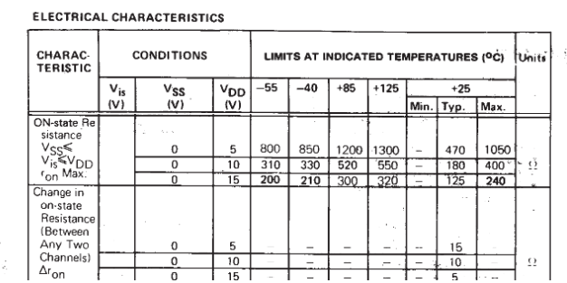

Anyway you are wrong about the on resistance for it, it can be well above 200ohm, here is from a old CD4067 datasheet:
Note: I removed some rows form this datasheet to make the picture smaller. The full datasheet is here: http://www.ti.com/lit/ds/symlink/cd4067b.pdf
"In the order of 200 Ohms," - yeah, well, 1k is in that order. :grinning:
The only use for the non-HC version of the 4000 series is where you want to use odd voltages - like 12 V. And analog multiplexing is about the only place where you would. :roll_eyes:
