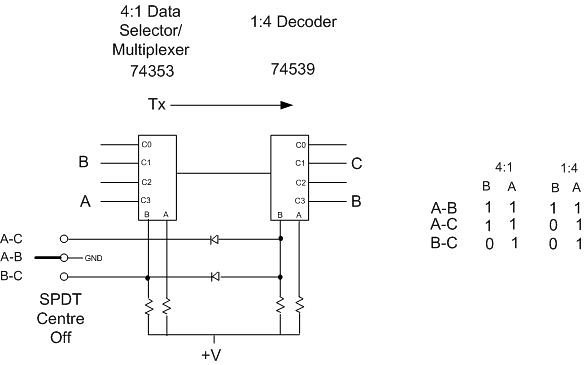

Essentially what I'm looing to do is have 2 embedded arduinos talk to each other over serial. But they'll need reprogramming in place, so I'd like a header for an FTDI lead on the board. Then, using a switch, I can select one of the 3 options:
  • Arduino A talking to Arduino B over serial
  • Arduino A talking to FTDI over serial
  • Arduino B talking to FTDI over serial
It looks like this is doable with a 4P3T switch, but the ones I've seen seem to be fairly bulky. Guess that's what you get for wanting so many contacts!

I sketched out a quick diagram of what I want to achieve. It allows each of A, B and C to communicate with each other over the serial pins using a 4P3T switch.
Sorry for messiness!

I revisited my answer
I could not find a quad 2:1 decoder, so stayed with dual 4:1
Here is half the answer, you need to do the same for the RX line. The same 4 address lines can be bussed to the othe multiplexor and decoder.
switch by ferroequinologist-srrl, on Flickr
The diodes keep the lines isolated (lookup diode matrix)

Many thanks for that Bill! Second arduino is due any day now, so will be giving various ideas a go.
