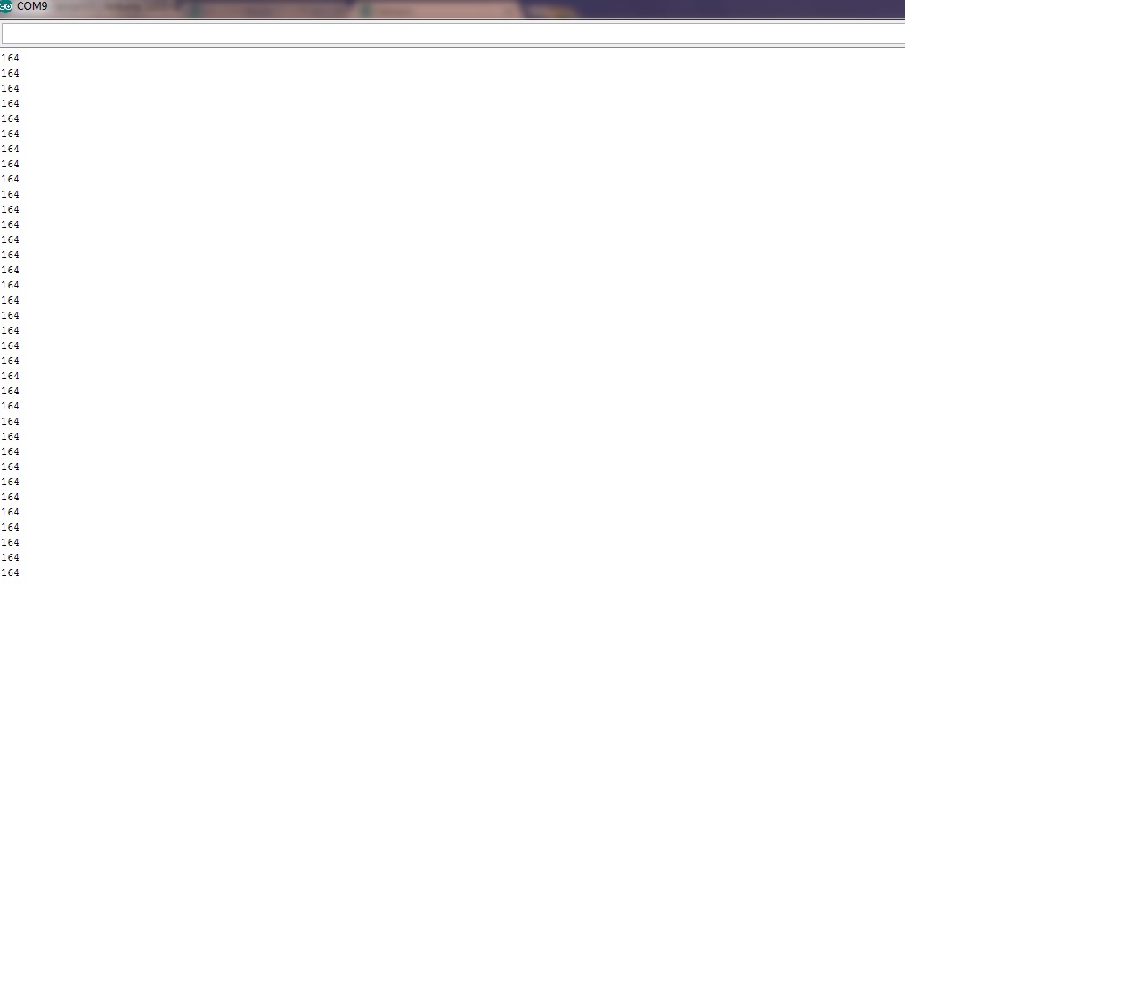

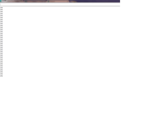

When i compile and Run it on Serial Monitor, it outputs a continuously value of 164 no matter what i do. Why is it so? Am i on the right track? Below is the pictures of the result that I've gotten when i run this together with the program code. Please feel free to highlight if there is any mistakes that I've done for this program. Thank you and hope you have a nice day.

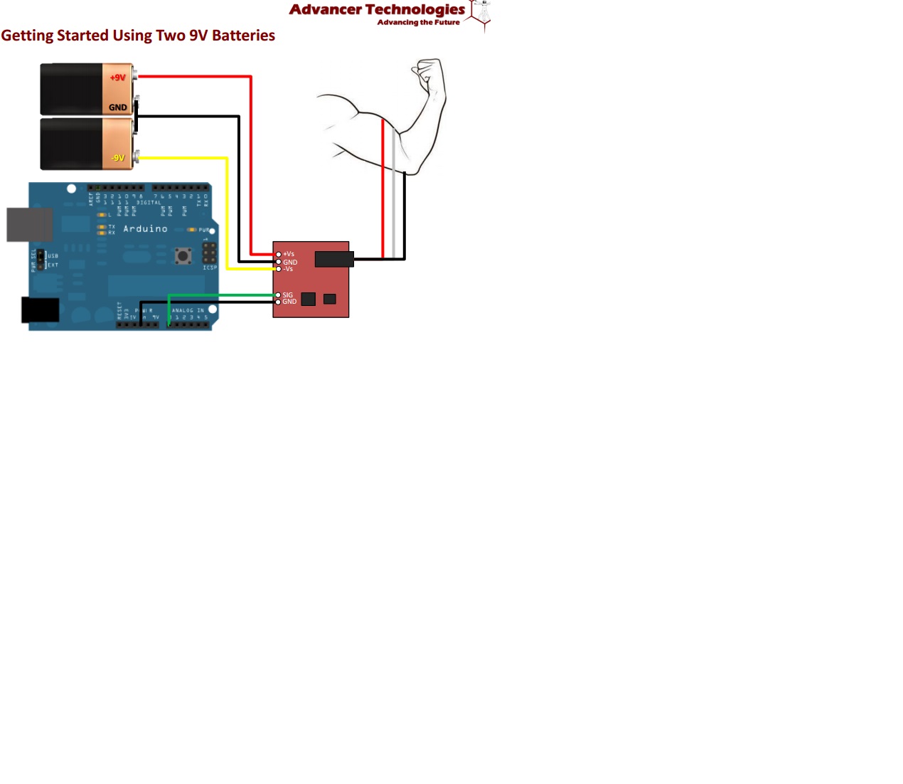

Hello i connect +Vs to the one of the positive +9V Battery and i short the Negative of both batteries together and connect to GND, for the -VS i connected it to the other positive side of the +9V battery.
And the SIG i connect it to Analog Pin A0 and the Gnd to Gnd. Pic attached as shown. Abit messy though :smiley: Thanks guys!!!

There's your problem! Your batteries aren't wired right. Did any of the chips on your board get hot or smoke? Your current connection could burn out the chips on the board.
To fix your setup, you should connect the positive of one battery to +Vs, the positive of the second battery to the negative of the first battery and connect to GND, then connect the negative of the second battery to -Vs.
You should use a multimeter to check the voltages at the +Vs and -Vs pins. They should read +9V and -9V respectively.

yes!! i smelt some smell coming from the device!! Oh my god! :frowning: what a mistake i've done!! Thank you i will try and let you know the results! :smiley:
now the value is continuously zero! Oh my god did i fried the board? :frowning:
Sorry but you probably did. :cry:
