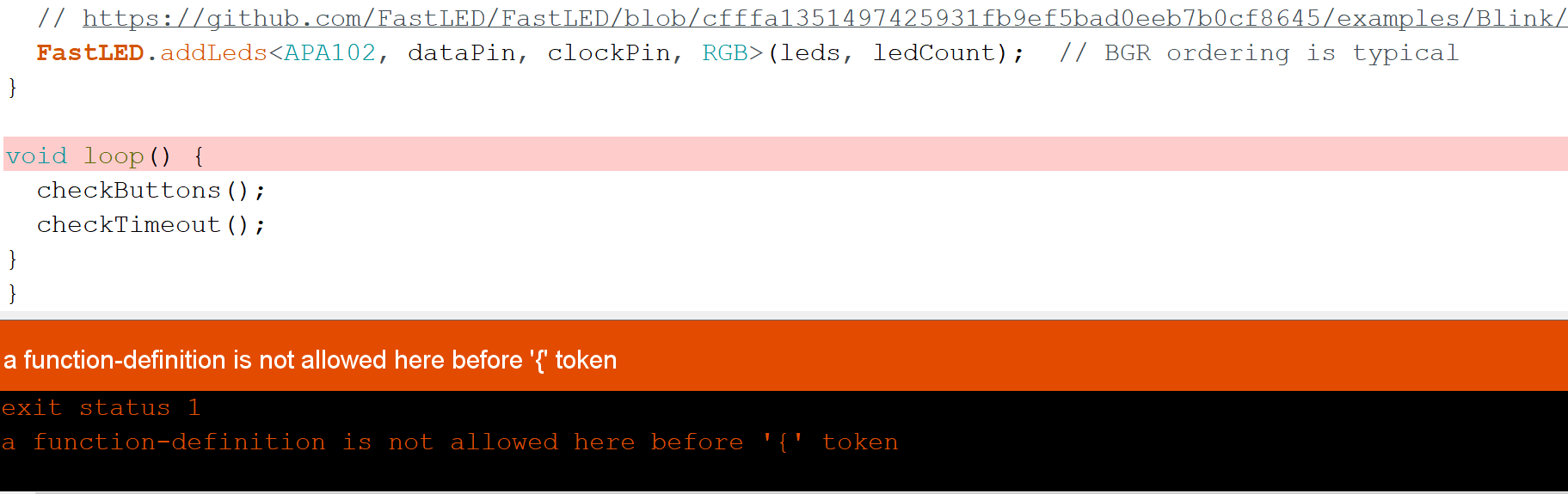

@groundFungus Thanks, I realized I had to download the FastLED library, which I tried to, but may not have done correctly due to the errors? In Arduino I went to Tools>Manage Libraries>and installed FastLED library.
@alto777 Thank you as well for the coloring info.
I in the code I had entered everything that needed change as far as I am aware but am still getting some error messages when i go to verify it. Can anyone see what may be causing the errors?

20210604_NatAreaMap_Arduino:97:13: error: a function-definition is not allowed here before '{' token
C:\Users\ryurkovich\Documents\Arduino\libraries\FastLED/FastLED.h:362:2: error: invalid declaration of member template in local class
template<template class CHIPSET>
C:\Users\ryurkovich\Documents\Arduino\libraries\FastLED/FastLED.h:312:2: error: invalid declaration of member template in local class
template<template<uint8_t DATA_PIN> class CHIPSET, uint8_t DATA_PIN>
C:\Users\ryurkovich\Documents\Arduino\libraries\FastLED/FastLED.h:237:2: error: invalid declaration of member template in local class
template<ESPIChipsets CHIPSET, uint8_t DATA_PIN, uint8_t CLOCK_PIN > static CLEDController &addLeds(struct CRGB *data, int nLedsOrOffset, int nLedsIfOffset = 0) {
and it goes on...
Thank you for your help and patience with my inexpertise.
this should be at the top of the sketch, not in the loop() function
#include <FastLED.h>
EDIT:
actually you probably pasted into a template sketch as there are bits and pieces of setup and loop...
the whole code should look like this

// Define led arrangement, see FastLED examples for strip definition
// https://github.com/FastLED/FastLED/blob/cfffa1351497425931fb9ef5bad0eeb7b0cf8645/examples/Blink/Blink.ino#L17-L57
FastLED.addLeds<APA102, dataPin, clockPin, RGB>(leds, ledCount); // BGR ordering is typical
checkButtons();
checkTimeout();
Ahh yes I probably did paste it in a template sketch thank you.
