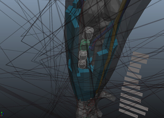

Here's the official design drawing of this proposed single motor actuating both forward and reverse directions with two separate Archimedes pulley systems opposing one another. You'll also note that the left hand side of the drawing has a pair of Archimedes 2:1 pulley downgear systems, one for forward and one for reverse directions of motor and these two are going to be very long (16 inches long) and therefore are located in torso. The remaining 16:1 Archimedes pulley downgearing systems will be kept in the forearms near to the finger joints they are actuating as we had planned originally and already have in place.
You'll also note the weight that hangs off the bottom of both of the 16" long 2:1 pulley downgear systems that can keep them both taught at all times despite their varying lengths that will always be changing. The weight is able to slide since it has a fishing hook eye above it and on both attachment points to the 2:1 pulley downgear systems so it is always adjusting these 3 fishing hook eyes to always keep tension on both systems freely.
