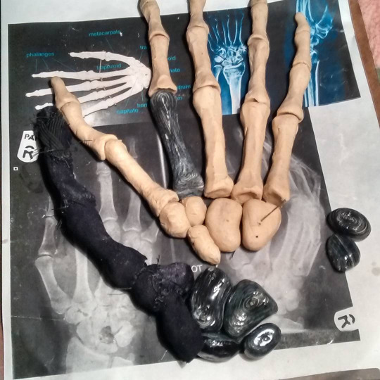

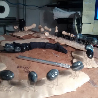

Stages of Robotic Hand Making
hand fabrication from clay to epoxy composite
Robotic Hand Bones Epoxy Drying
The Ulna Bone Ready to Go!
epoxy composite ulna bone finished

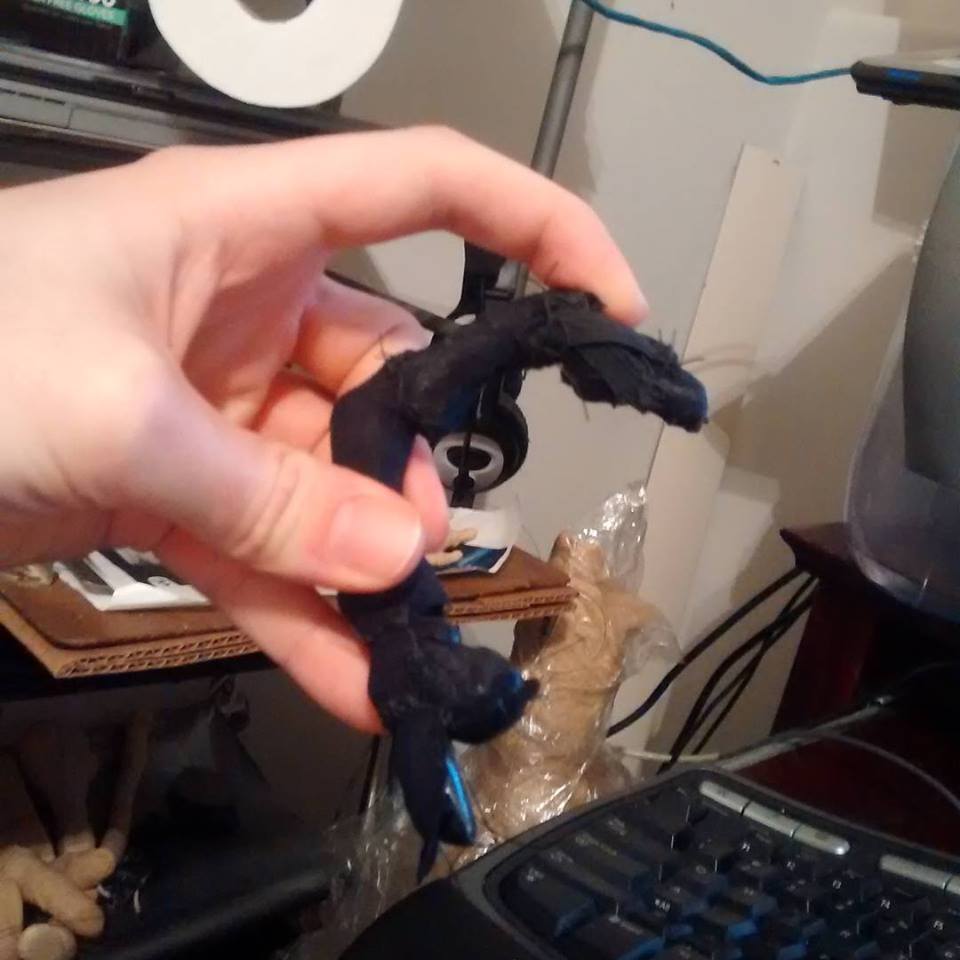

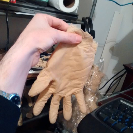

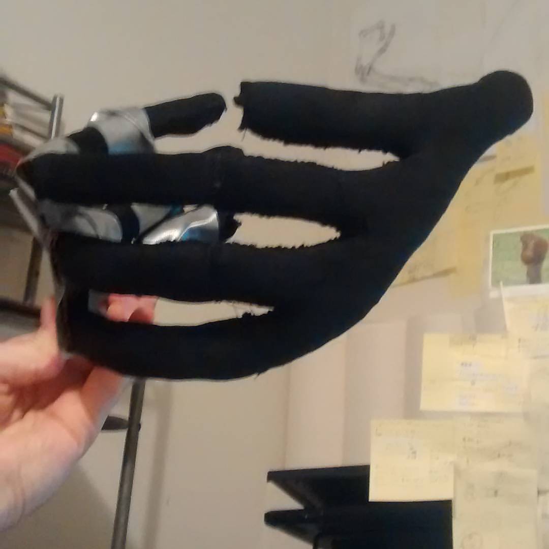

Silicone Hand Practice First Attempt
Flexible artificial tendons of the thumb!

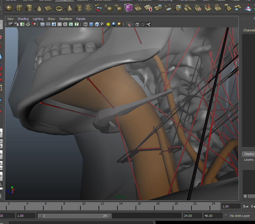

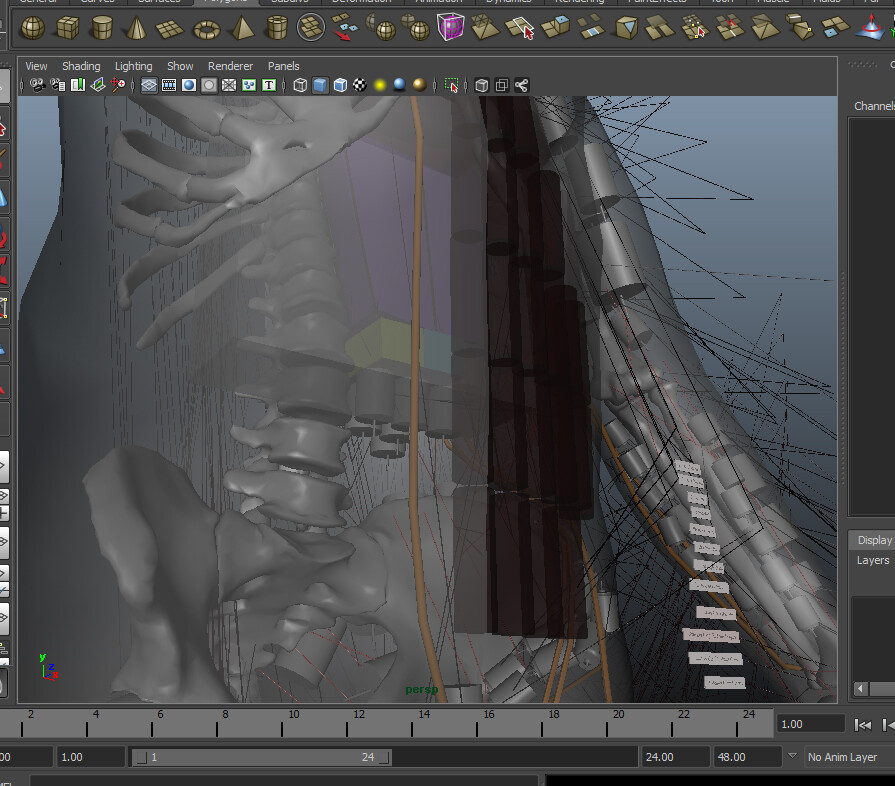

3d Blueprints of Robot to Scale:
full torso overview

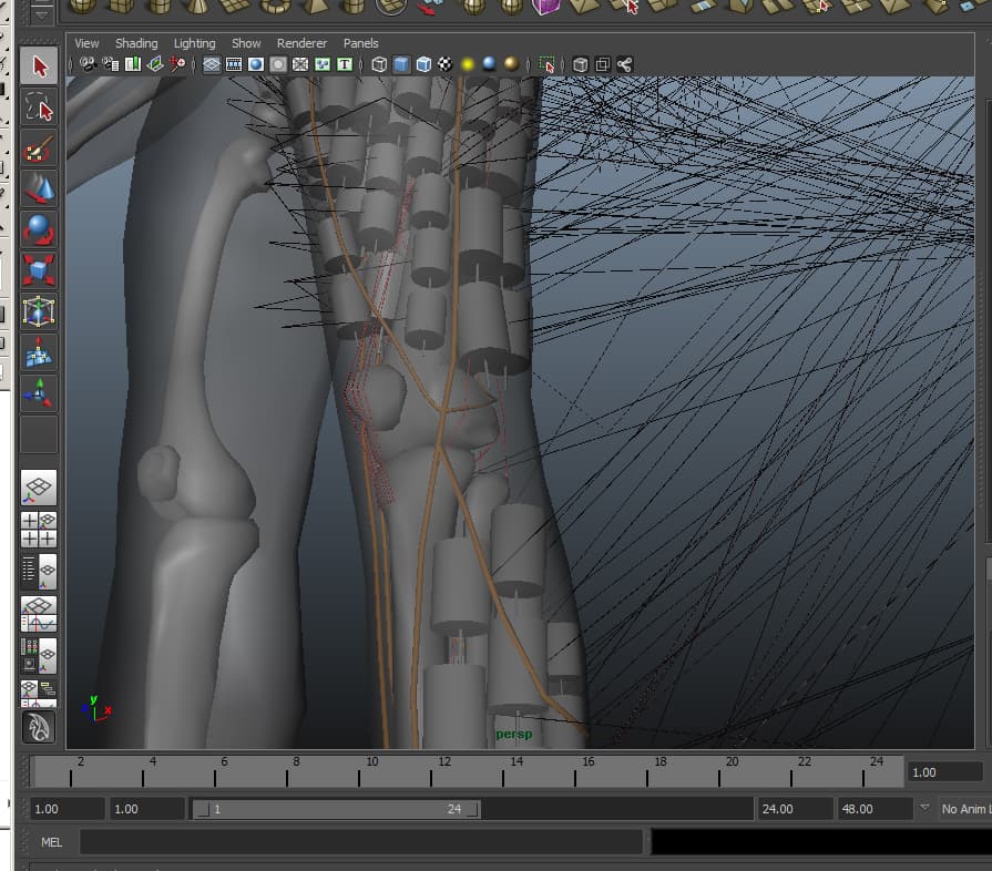

detail of labeled muscles and motors placement on arm
detail of legs filled with motors
detail of shoulder and neck blueprints
neck design closeup
batteries in abdomen area and main pc mounted behind them and cooling systems behind that

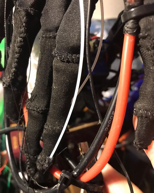

robot hand bones sewn into flexible artificial tendons of spandex
robot hand side view sewn and ready for electronics

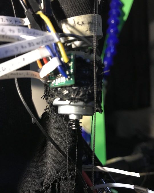

brushed dc motor custom servo sewn into forearm detail
custom servo detail closeup
2s temporary battery supply for forearm motors testing
rearview of custom battery holder

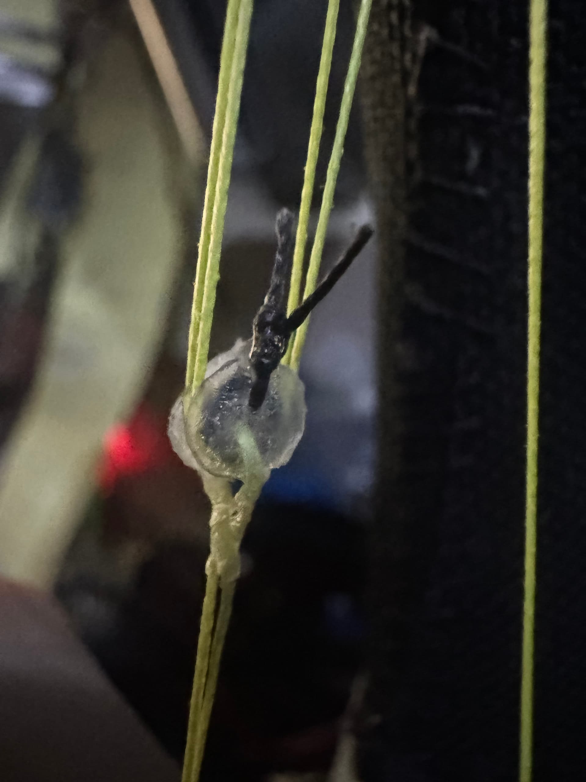

.3mm id teflon guidance tube for muscle string for index finger distal joint

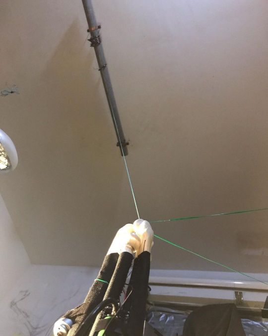

ceiling mounted rail setup for lowering robot onto work area suspended from ceiling

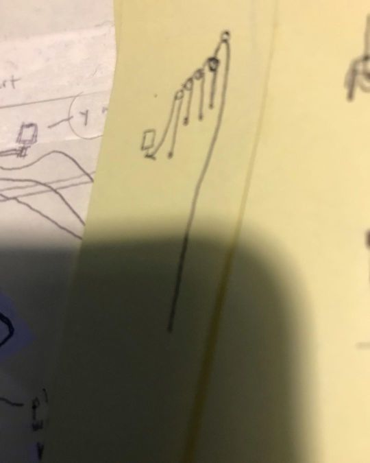

compact archimedes pulley system design for "downgearing" servo muscle string output
hereโ€™s my archimedes pulley downgear system CAD for my 2430 bldc motor for finger actuation. This will give 64:1 downgearing. Compare this to 180:1 standard downgear ratio in a hobby mg996r servo motor for example. Will be a bit faster than that then but still plenty of torque with this beefy bldc motor (200w motor). I prefer pulleys over gears since they will operate mostly silently whereas gears are noisy. I think this pulley system is the secret sauce of my plans that I am not aware anybody has done yet. It could be the standard for humanoids one day maybe if it is as good as I think it will be. Still experimental but Iโ€™m going to be prototyping this soon. I will be making my own bearings for these pulleys so the whole pulley is custom made. Well some pulleys Iโ€™ll be using purchased mini ball bearings and some pulleys Iโ€™ll be making the bearings as plain bearings using stainless steel tubing which I can cut to size with my dremel to make the plain bearing. Another HUGE benefit of pulleys over gears is gears generally are mounted to top of motor which really makes a large volumetric area taken up by the motor and downgearing which creates space concerns for fitment inside tight spaces in humanoid form factor (particularly when you use a human bone structure instead of a hollow 3d printed arm with no bones which some have done to accomodate geared servos inside the hollowed arm space). So by translating the motorโ€™s turning by way of braided PE fishing line to a pulley system like this, you can decouple the motor from the downgearing in your CAD design, placing the downgearing in a convenient place separate from the placement of the motor which allows for creative rearranging possiblities that enable you to cram way more motors and downgearing into the very limited spaces in the robot. The motors and downgearing is fitting where muscles would normally be in a human body so you want elongated narrow fitment options and this way of downgearing lends to that shape requirement well. Also it is nice not to have to worry about making or buying gears which can add cost and complexity and weight and a lot of volume concerns. The noise elimination will be huge.
Iโ€™m planning to use .2mm 20lb test braided pe fishing line on the finger motors that will run to the pulley system and then swap to 70lb test line for some of the lower pulleys where the downgearing has beefed up the torque quite a bit and the tension will be higher there so going thicker line then. 70lb test will go to fingers from the final pulley of the archimedes pulley downgearing system.
The 70lb test PE braided fishing line (hercules brand off Amazon) is .44 mm OD and pairs well with .56mm id ptfe teflon tube I can buy on ebay. The 20lb test PE braided fishing line (hercules brand off Amazon) pairs well with 0.3mm id ptfe teflon tube. The tube acts just like bike brakes line guidance hose to guide the string to its desired location. Teflon is naturally very low friction. I may also lube the string so the friction is even lower inside the tubing. Iโ€™d use teflon lubricant for the lube.
I will be actively CAMPAIGNING AGAINST use of gears in robots because I think they are too loud and obnoxious. BLDC motors are quiet and pulleys should be quiet too. Having powerful, fast, and very quiet robots is ideal for home users who donโ€™t want a super loud power drill sound coming off their home robot. I believe this downgearing by pulleys solves all of this and aught to be the way downgearing is done for humanoid robots as the standard approach going forward. - but of course someone has to be first to do it to prove it and show a way to approach this method and I seem to be the one for this task. Note I canโ€™t recall but maybe there was one asian robotics team that used pulleys not sure. I decided on pulleys before I came across that team but Iโ€™m fuzzy on that teamโ€™s design now. In any case, nobody to my knowledge has fully downgeared to 32:1 or 64:1 type ratios by way of pulleys before now so Iโ€™m definitely innovating that imo.

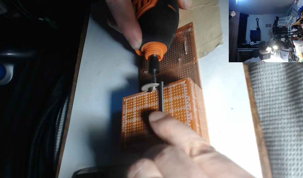

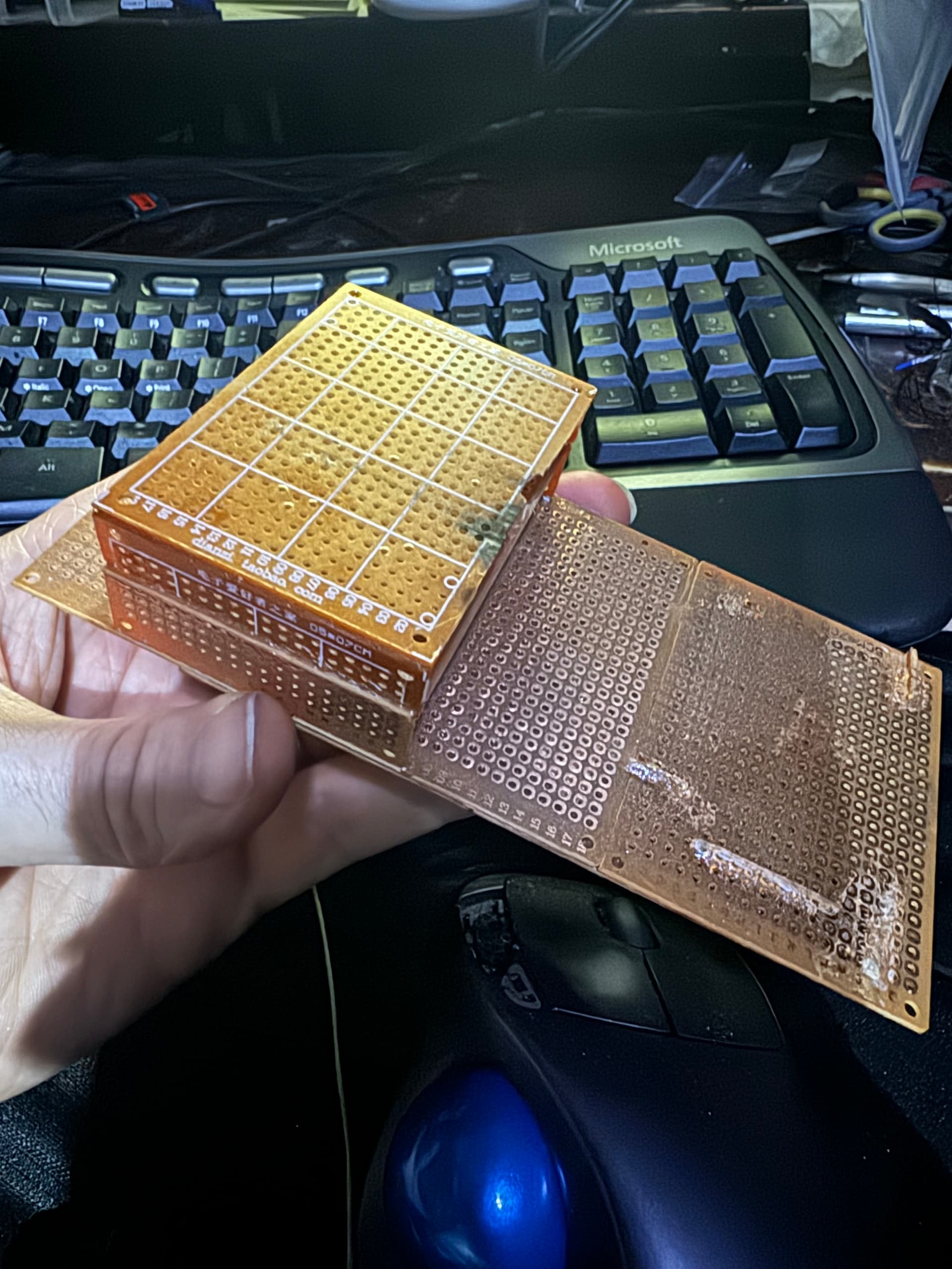

Here are some plain bearings parts I made with my Wen rotary tool (aka dremel) with diamond disc attachment and some files. They are made by carefully cutting stainless steel tubing (purchased on Amazon) into short 1mm lengths. The tubing is:stainless steel tubing 3mm OD 1mm wall 250mm length $5, 5mm OD 0.8mm wall 250mm length $5. These should make around 125 plain bearings (accounting for 1mm+ lost per cut in wasted length of metal). So that's about $0.08 per plain bearing.
These are intended to be 1x5x1mm plain bearings. I mean they are basically like a wheel and an axle with the axle having a hole through the center of it lengthwise. These will go into the last few pulley slots in my Archimedes pulley downgearing system. The last few pulley slots have the highest torque at 16:1, 32:1, 64:1 for the last 3 pulleys landing us on our 64:1 total downgearing goal. Because the forces here are reaching into 27lb range (the final output of the system), ball bearings cannot be used at these tiny bearing sizes because they are not robust enough and not rated for these high forces whereas plain bearings can handle it because they don't have crushable little balls and thin walls and stuff but instead are just two pieces of solid metal and hard to break. Less moving parts and more robust. Yes, they have more friction is the trade-off. So we prefer ball bearings until ball bearings can't handle the torque without being large ball bearings - too large for our volumetric space constraints - at which point we swap to plain bearings to handle the bigger torque while maintaining the small pulley sizes we want.
Note that I constructed this little dremel cutting lineup board out of 5x7mm pcb prototyping boards and super glue. It gets the height of the spinning dremel diamond disc lined up with a little pcb board "table" on which the stainless steel tubing can lay flat and perpendicular to the cutting blade and be carefully fed into the spinning disc to make a near perfect cut. I eventually think I should improve on this board design to add sliders and adjusters and endstops etc because as it is now it is too manual skill requiring and free-handish. That means more time spent filing down imperfect cuts later. But it did the job for the time being. I also bought a 2" miter saw chop saw off Ebay with some abrasive metal cutting discs which I want to try once it comes in and compare it to this setup I'm using now in terms of accuracy. It was called "mini bench top cut off saw 2in" at $38.51. shipped.
