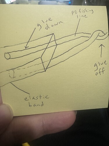

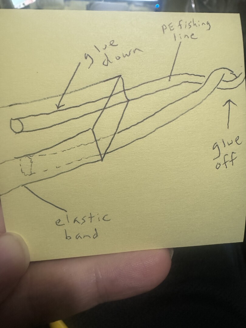

Note: the total length of the elastic band I am using for this is 2ft and it stretches to 3ft snugly without too much force. I'm just going by feel and instinct for this measurement. If I were to go 1ft with 1ft of stretch, the stretch is more intense and the pull is harder. But I don't think I need much pull for just tensioning the winch in place pulley and I also think the more tension you place the more wear and tear on the elastic band which will shorten its lifespan. So playing it conservatively with the 2ft length selection for now.
Note: to apply the 401 glue I used an exacto knife handle with a sewing needle in place of the xacto knife blade and the tip of the sewing needle acts as my precision glue applicator.

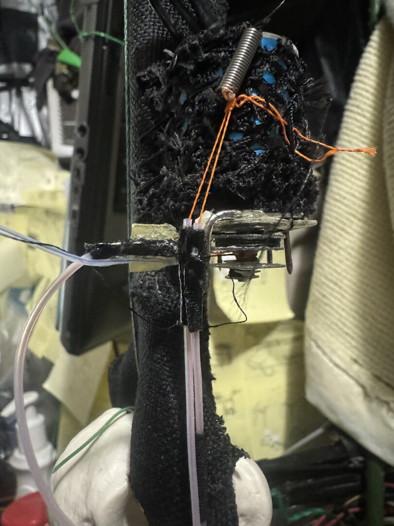

Minor update: I have now carefully mounted the PTFE tubing that leads to the elastic string tensioner for the winch in place pulley. I mounted it snugly to the side of the PTFE tubing coming off the same winch in place pulley that leads to the Archimedes pulley system. I routed both of these using my CAD for reference in such a way that their routing will not interfere with the next motors that will be installed later. I mounted this PTFE tubing that leads to the elastic string tensioner using ONLY 401 glue which is something I've never tried before now. Usually I first wrap the tubing in adhesive transfer tape and spandex cloth wrap and coat the cloth in 401 glue but skipping that made it able to be more snugly mounted to the other tube by way of only glue. We'll see how that holds up without the other reinforcement the cloth provides etc. Seems to look so far so good though. They are in turn glued to paper soaked with 401 glue and to a little piece of stainless steel wire bent at a 90 and that wire in turn glued to the winch in place pulley mount baseplate which is itself made of paper and 401 glue. So basically everything is becoming 401 glue construction! I have some concerns about how this will hold up in the event of a fall or w/e but perhaps we can create some sort of protective cage around any delicate outcroppings like this in the future. For now I am just going for ease of construction and speed of construction to get things back on track and rolling again.
Note: The PTFE tubing that leads to the elastic string tensioner for the winch in place pulley is 0.66mm ID 1.16mm OD PTFE teflon tubing. The string coming off the winch in place pulley feeding into this tubing that will act as tensioner string tension carrier string is 6lb test 0.08mm PE braided fishing line. I was able to thread this fishing line into this TPFE tubing by hand with no issues at all very easily.
The next task will be to mount the end of this string to the 2 feet of elastic string for jewelry making and thread that into 1.8mm ID 2.2mm OD PTFE tubing and tie it off at the end of that tubing and then mount that tubing to the gray string hanging from my ceiling for now. That will conclude the tensioner mechanism for the winch in place pulley and this will usher in the next round of manual hand testing to see how much tension that is giving us. I also will be moving the tension spring mounted on the motor to align it better and shorten it more since it only moves like 4mm and so can be way shorter than it is now.

Note: to secure the far end of the elastic bracelet cord I used 401 glue to glue on PE fishing line onto its end the same way as we discussed before and then took the far end of this PE fishing line and came out the end of the PTFE tube with it and taped it off onto the outside of the tube. We'll see how that holds up it might need to be glued down if it gradually is pulled through the tape over time which would be no good.
