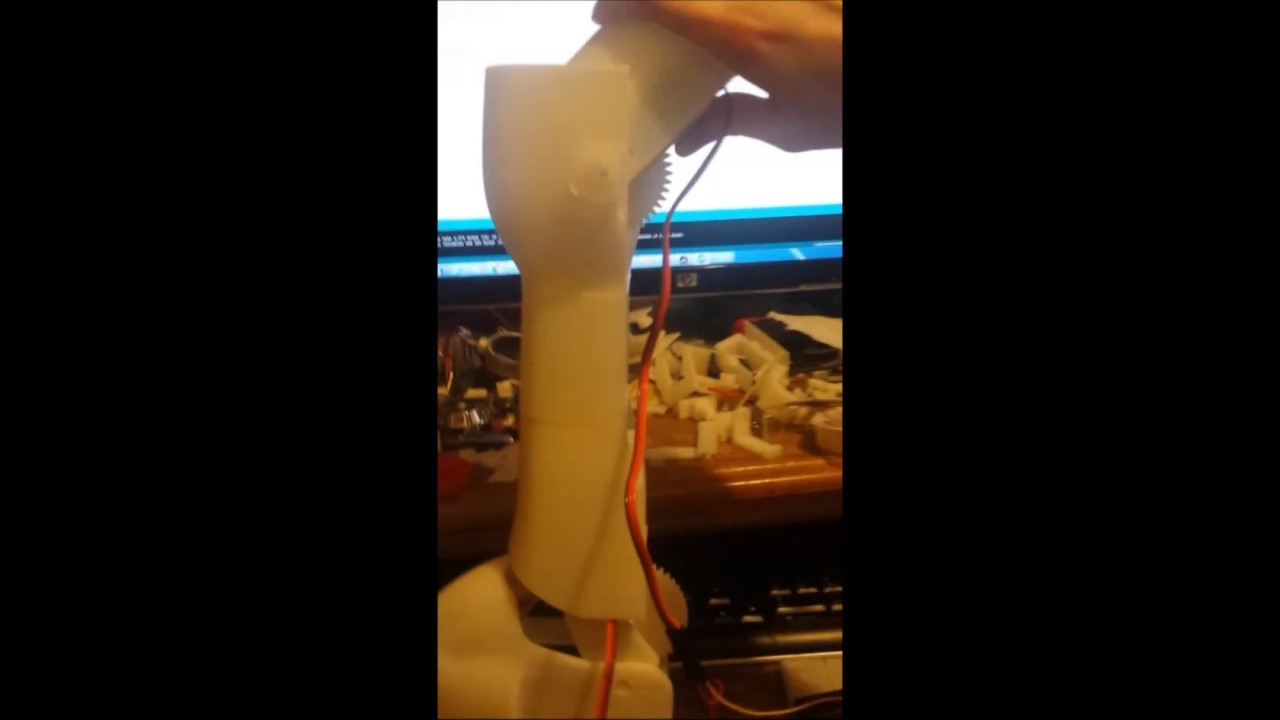

Printed off the foot. Going to print off the shin piece once I got everything correctly sized to fit together since I think my servo 3d model is abit off.
I think my x axis stalled from barely overheating a couple times during the print (had this issue with long prints in the past). I re-installed a fan back onto the motor and I think that should take care of it.

Lets talk torque. Its measured in Nm not kg. You mention this thing will be about 1m tall, so
to balance or manipulate that long a lever arm there will be a lot of torque needed. What is
the estimated total mass?
(Lets assume 500g, 0.9m long, uniformly distributed mass, to hold that out horizontally takes
about 3 Nm, which is a lot. To balance from 10 degrees to the vertical would only be about 0.5 Nm
which would be within the MG996R's nominal ability. All assuming 500g mass of course. I suspect
the backlash / play in a servo is going to be an issue. Note that stall torque rating for a servo is not
a sustainable rating, the servo will overheat and probably melt if held at that torque for a prolonged period.

The entire android atm is made out to be 33 inches tall or 860 cm. Each leg is 43 cm or around 17 inches. It got 1.5 inches taller after I revised the chest but I don't see it getting much taller now thankfully.
I could probably give a good estimate of the final weight but i'm about to print the other leg and waist sections so I can give an accurate value soonish. I'm assuming i'm going to get some stalling problems in the most bottom motor's in the foot since this is where I had trouble in my 8 inch micro servo legs. I was able to get around it though and had it doing a walk cycle from a start position for a couple minutes no problem which is enough for me to learn from and play with.
This project is mostly a learning experience of forces at play(along with 3d printing large connecting pieces that aren't warped at all).

Update: Got both the legs and hip connected and calibrated the motors. They balance alright though they aren't quite rigid enough yet because the 3d pieces I printed that connect to the servo's don't completely secure them and can slide around a bit. The plus side is i can slide them on and off relatively quickly to tweak things so its fine for now.
image removed, redesigning robot
I haven't tested the motors with everything all hooked up but judging from the performance of a single leg i don't think there will be any issues. At least not until the upper torso is made adding more weight.

Anyways, project reboot! I've been redesigning the robot from the bottom up to be sturdier with more functionality and i'm close to obtaining 50% completion. I just finished designing and printing the left leg and hip section. Once i'm happy with how that leg performs ill mirror duplicate it,print the right leg, and hopefully have a 2 legged robot that can take some steps.
There is some weak points and places it needs a redesign but it does function with the correct movements. I think i'll wait till the other leg is completed before posting a photo of the 3d printed counterpart.
I've improved the knee joint so it functions much better now and applied the improvements to others. Getting closer to the point where I can build another leg and have it attempt its first step.
Update on progress:
The entire leg except 1 motor attachment has been printed and assembled. I would have that part done now but i'm short one motor so it will have to wait till my next batch arrives. The leg from the knee down is very sturdy but the thigh to hip section has weak areas that need to be reinforced later.
The leg should be far enough along now that I can test some compound movements and upload the results. I can't use this plastic breadboard with the amount of amps ill be pulling so I need to go shopping and rig something up first before I can do any tests.
