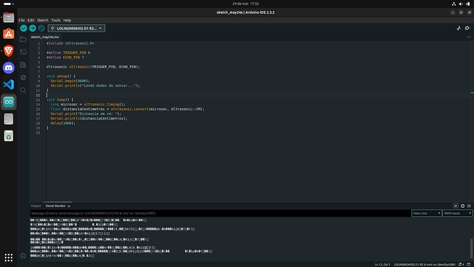

My arduino printing garbage
i'm using a lolin(wemos) d1 r2 mini
here is the code

simply this is to print �����!��D�9;��9��h,����fL����@H�80����0��?)�6!���9��U�.�JC�����!���)9;��9K$jBC.���!9�DŇ!9�DŇ����h0�8�?�FJ
what should i do ???
  • Did you set the Serial monitor to 9600 baud ?
What is your serial monitor configuration?
Serial.begin(9600) ???
I really don't know, it's my first time working with this on linux ubunto and my first time with a sensor and arduino, how can I know the serial monitor?
can you fit the code I made?

but it's already at 9600

It does not print show the line
Reading sensor data...
tells that the serial connection is not the same at both ends.

Wemos D1 Mini only likes a baud rate of 74880
(oddly enough this "printing garbage" link is using the EXACT same sketch)
Remove the ultrasonic sensor and re-upload the sketch (Do not re-connect the ultrasonic sensor, leave it disconnected). Does it print normal then?
if yes -> something to do with ultrasonic sensor -> wemos D1 R2 is 3.3v logic, but the ultrasonic sensor is 5v. Not sure if it's messing up the wemos D1 R2.

Are you sure it isn't the boot data you're looking at, which comes in at 74880 baud.
Set the serial monitor to 74880 to see it :slight_smile:
