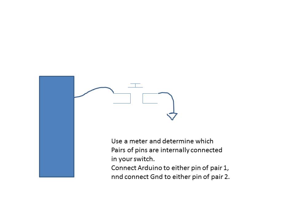

Thanks but when you say between pin and ground do you mean the switch with its 4 pins, do you mean ground and pin on either side of the switch, or on one pin?

Ok quick update to everyone, I know for a fact that the servos are fast enough, as I ran a few tests without buttons etc, and they can easily get the distance within 200 milliseconds. So, I think that the problem is probably my wiring. Has anyone got a frizzing diagram or any diagram of how my switches should be wired?
Thanks
AWOL:
So, you're shorting the power supply?
Oh dear.... help!
See attached.

CrossRoads:
See attached.
Thank you - sorry, it turned out to be my own incompetency when wiring up the switches rather than anything else.
