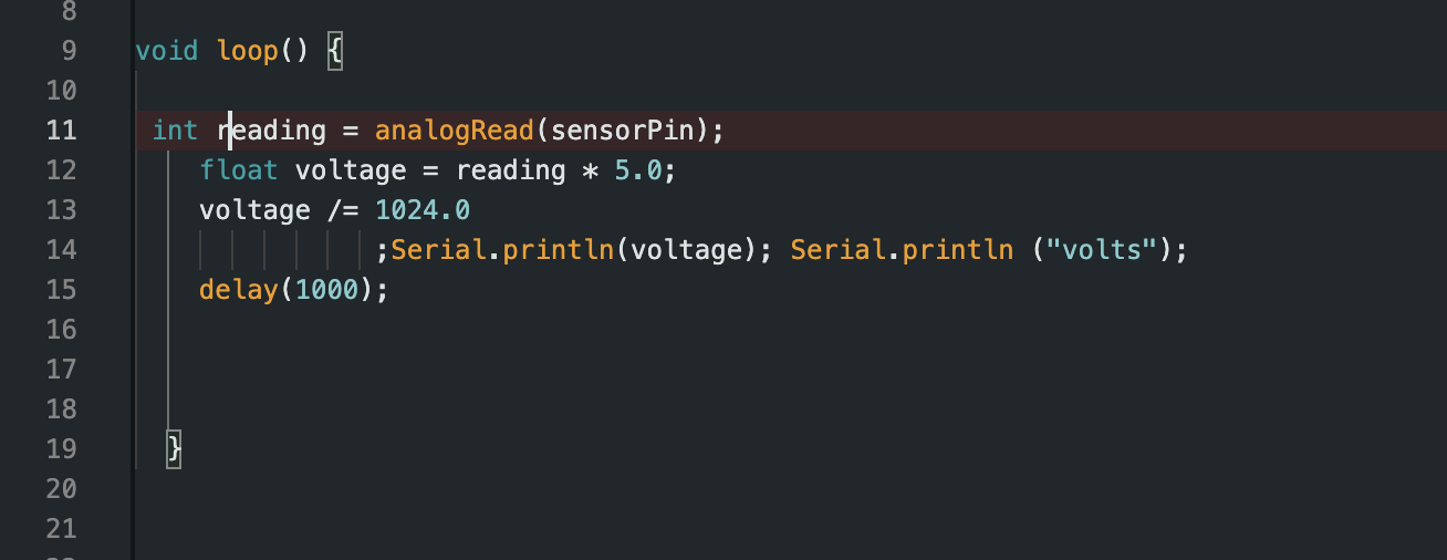

How do I compile the Code?
It also says that sensorPin does not belong there?

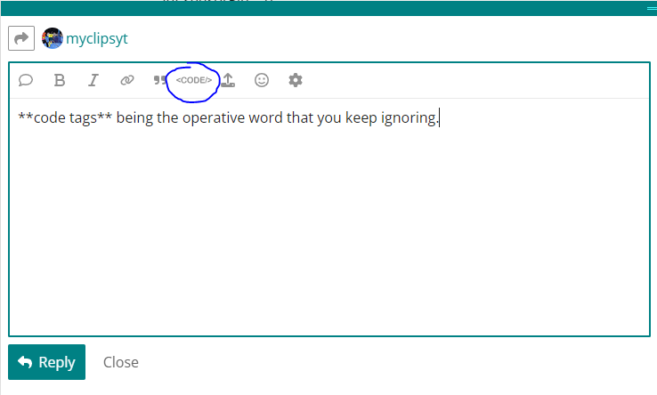

Can you please copy and paste your code in code tags

/Users/radley/Documents/Arduino/sketch_oct07a/sketch_oct07a.ino: In function 'void loop()':
/Users/radley/Documents/Arduino/sketch_oct07a/sketch_oct07a.ino:11:27: error: 'sensorPin' was not declared in this scope
int reading = analogRead(sensorPin);
/Users/radley/Documents/Arduino/sketch_oct07a/sketch_oct07a.ino:11:27: note: suggested alternative: 'constrain'
constrain
exit status 1
Compilation error: 'sensorPin' was not declared in this scope

Please note I said in code tags. That goes for error outputs too.
oh ok sorry
int sensorPin = 0;
void setup ();
float voltage = reading * 5.0;
voltage /= 1024.0
;Serial.println(voltage); Serial.println ("volts");
code tags being the operative word that you keep ignoring.
I'm so sorry

Try that. The sensor pin is now a global variable.
Also 0 is for a Digital pin. A0 is for the Analogue input pin.
The setup() function should not have any declarations inside it.
The maximum value from analogRead() is 1023 (not 1024). The division should use 1023.0 to get the correct voltage range.
I changed the Serial.println() to use Serial.print() for the voltage followed by Serial.println() for the string "volts" to make the output clearer.
This is very bad practice, makes it hard to read. Press CTRL+T in the IDE to fix the indentation, too.
IT WORKED yes thank you so much
