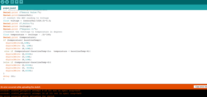

the code verifies ok but I just get the error message cant upload; any suggestions?

Post the full error message and the code using code tags

Arduino: 1.8.19 (Windows 10), Board: "Arduino Uno"
Sketch uses 4030 bytes (12%) of program storage space. Maximum is 32256 bytes.
Global variables use 230 bytes (11%) of dynamic memory, leaving 1818 bytes for local variables. Maximum is 2048 bytes.
An error occurred while uploading the sketch
This report would have more information with
"Show verbose output during compilation"
option enabled in File -> Preferences.

C:\Users\Nick Savage\AppData\Local\Arduino15\packages\arduino\tools\avrdude\6.3.0-arduino17/bin/avrdude -CC:\Users\Nick Savage\AppData\Local\Arduino15\packages\arduino\tools\avrdude\6.3.0-arduino17/etc/avrdude.conf -v -patmega328p -carduino -PCOM5 -b115200 -D -Uflash:w:C:\Users\NICKSA~1\AppData\Local\Temp\arduino_build_354036/project_book2.ino.hex:i
avrdude: Version 6.3-20190619
         System wide configuration file is "C:\Users\Nick Savage\AppData\Local\Arduino15\packages\arduino\tools\avrdude\6.3.0-arduino17/etc/avrdude.conf"
         Using Port                    : COM5
         Using Programmer              : arduino
         Overriding Baud Rate          : 115200
avrdude: stk500_getsync() attempt 1 of 10: not in sync: resp=0x00
avrdude: stk500_getsync() attempt 2 of 10: not in sync: resp=0x00
avrdude: stk500_getsync() attempt 3 of 10: not in sync: resp=0x00
avrdude: stk500_getsync() attempt 4 of 10: not in sync: resp=0x00
avrdude: stk500_getsync() attempt 5 of 10: not in sync: resp=0x00
avrdude: stk500_getsync() attempt 6 of 10: not in sync: resp=0x00
avrdude: stk500_getsync() attempt 7 of 10: not in sync: resp=0x00
avrdude: stk500_getsync() attempt 8 of 10: not in sync: resp=0x00
avrdude: stk500_getsync() attempt 9 of 10: not in sync: resp=0x00
avrdude: stk500_getsync() attempt 10 of 10: not in sync: resp=0x00
Hi @savagen. Please add a reply here on this forum topic to tell us which Arduino board you are using.
I see from the output you shared that you have Arduino IDE configured for use with an UNO R3 board. However, something that can be confusing is there are multiple boards with "UNO" in their name:
We need to be certain of exactly which one you have. The reason is that the problem might be caused by the IDE not being correctly configured for your specific board.
If you aren't sure which one you have, you can provide a picture of the board or a link to the place you bought it from and we'll see if we can identify it.
Board is mega2560 R3.
Which board have you got selected in the IDE ?
its elegoo mega 2560. can't see how I put that in board choices?
Try using "Arduino Mega or Mega 2560"
thanks!!! that works. much appreciated!
Glad it worked
