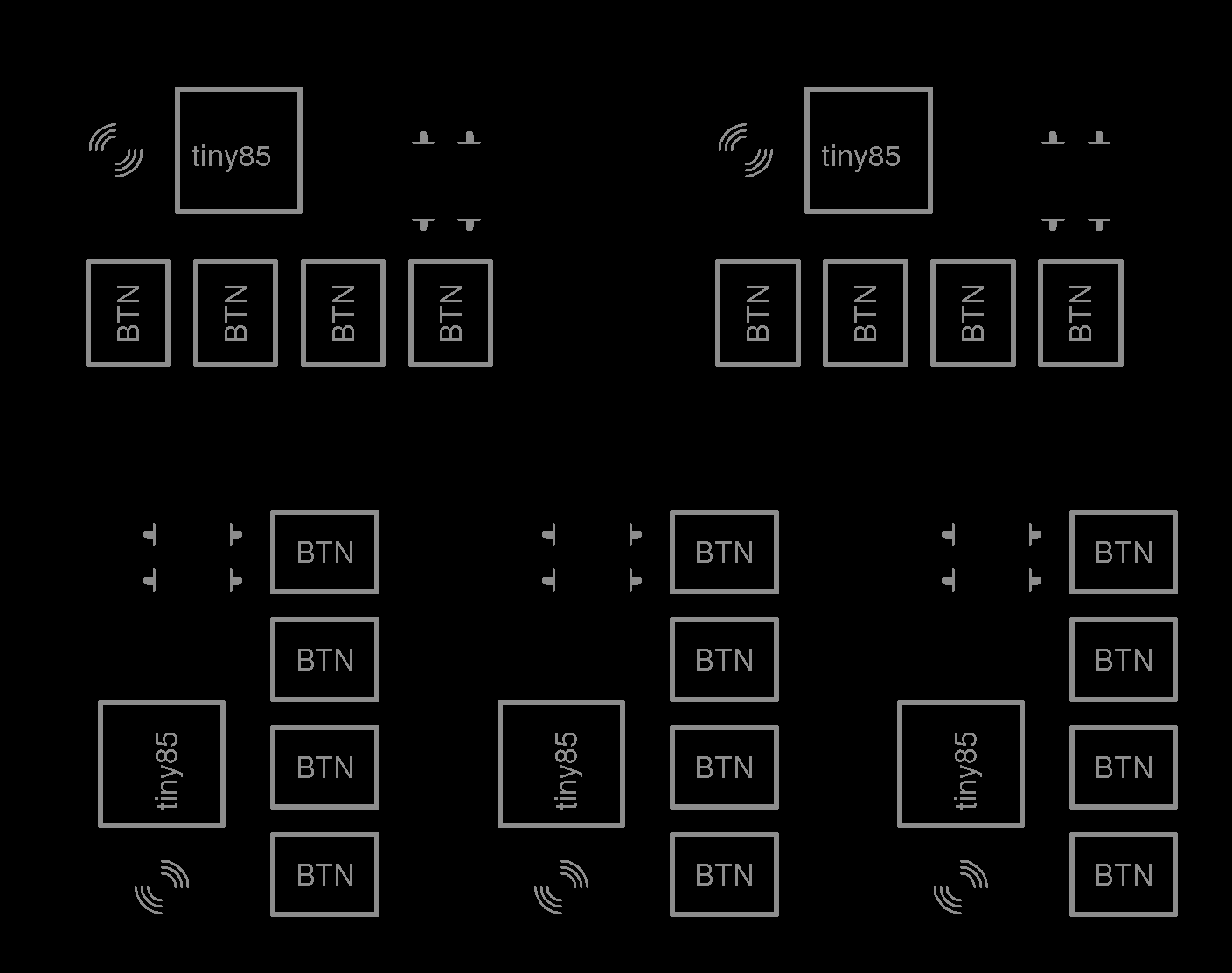

My first Eagle Board...is it right? Or am I about to waste time and money?
I have copied the same schematic 5 times on to one 8x10cm board space...
Here is a copy of my .brd file if you need it!

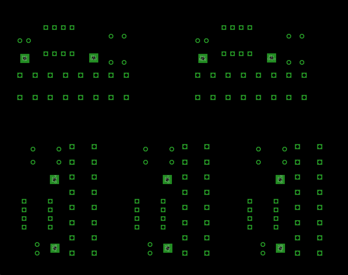

I have printed the board on to paper and the bits seem to "fit"...I am more concerned about like hole sizes...tracks...and...stuff?

All layers

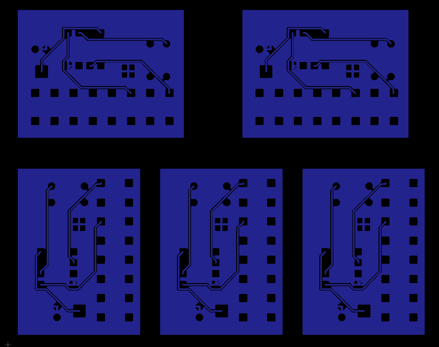

Top trace Layer
Bottom trace layer
All layers except Top and Bottom.
Pads:

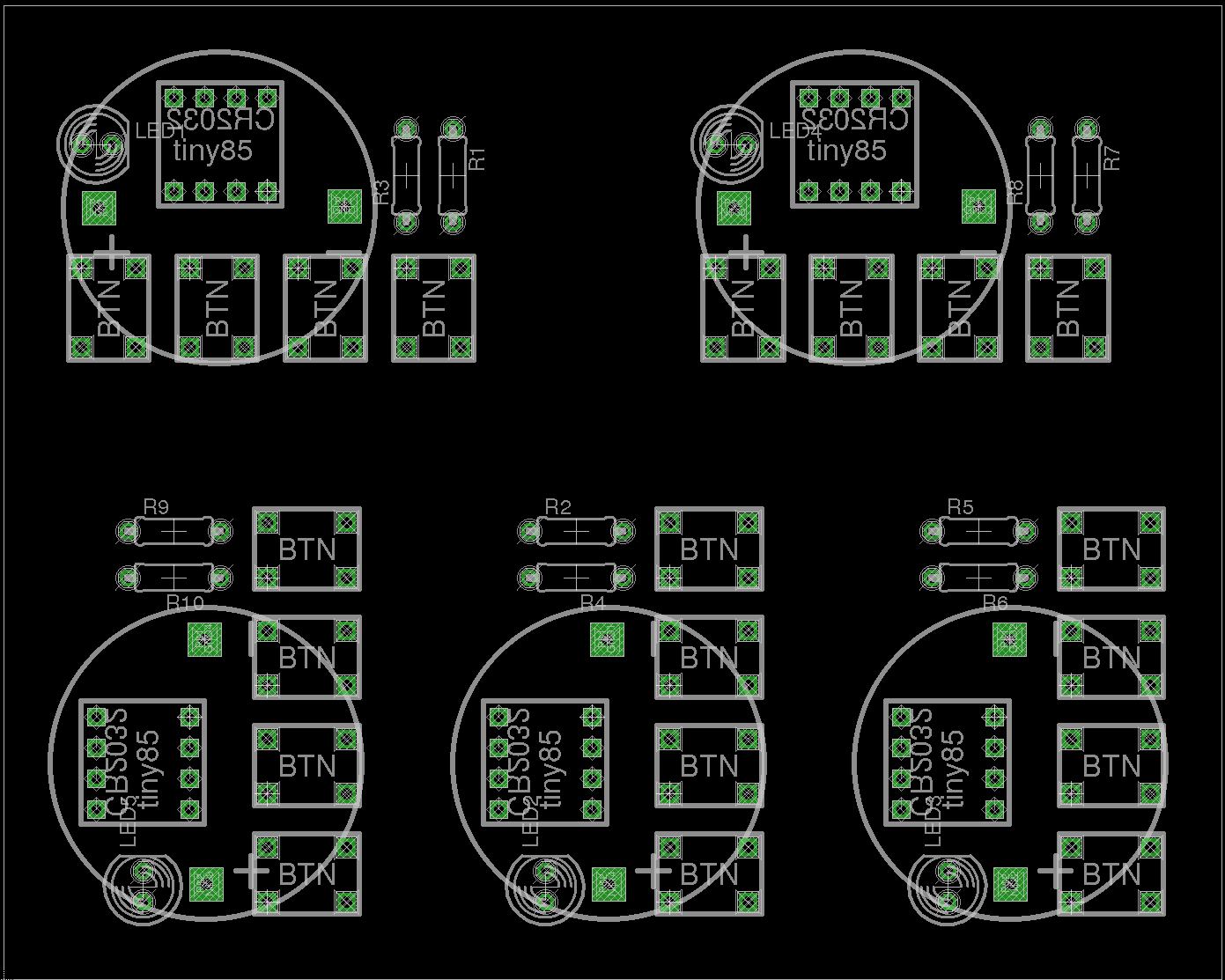

Top_Document:
Bottom Document:
Just about all of your tracks are sliding right up against other "stuff". You should give yourself more space. Sure, the board house says they can handle those tolerances but why test them?
Adjust your default grid to .025" or even smaller and you'll have an easier time getting tracks set right.
You need at least one .1uF capacitor between GND and VCC on any IC on any board, and then it never hurts to go overboard with extra capacitors if you have the space - nobody will force you to populate them, but if you find out you need them when you're putting your circuit together you'll be happy to have those spots available. De-coupling.
Typical rule for polygons is that the top polygon is VCC and the bottom is GND. Somehow your bottom plane is "GND4" which makes me wonder how many voltages you expected to deal with.
Personally I like to create mounting holes in the corners of all my boards (you can do this with a big via).
You didn't include your schematic; I'm too lazy to check for any problems there.
Thanks for the feedback! I will say try and give a good 50% over the manufacturer's "minimum".
My prototype breadboard circuit works without the smoothing cap but I will add one just in case!
I assume I want the corner vias to not actually go though the two polygons...otherwise that would be an instant short-circuit across the supply?
Eagle will automatically isolate any vias you add in. That should be apparent after you add the via and click the "ratsnest" button.
Also, you might want to try out that "Layer Settings..." button and deselect "tstop" and "bstop". It's only a visual thing; unchecking those makes it a bit easier to see what's going on.
I have highlighted a couple of rerouting of tracks to help clearances.
I would be making my tracks thicker.
Make you solder pads for the buttons bigger as they have to be mechanically sound as well as electrically.
You have lots of copper to use as conductive tracks, use it for conducting your circuit.

Mounting Holes? I see you have some thru holes in the corners, but what are their diameters?
a small #4 screw needs 3.5mm dia hole, and a 7mm diameter pad (0.138" Hole, .276" Pad)
With your Ground and Vcc layers, I suspect you would not be able to use your mounting holes without shorting out VCC to Gnd.
When I use #4 screws, I leave a 10mm clearance (keepout) to minimize the potential for shorting out any signals.

The copper layers are clear around the vias so I am unsure as how this would cause a short?
They are M1.6 screw sized....~.0629"
Per DirtyPCB's faq, "separate unconnected designs will be refused by the board house".
If you want multiple board designs to count as one design, you must panelize it your self - in this case, that means drawing the boundary between them on the milling layer, complete with the "rat bites"
