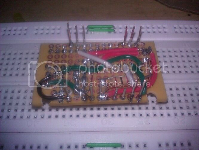

It's a little wacky but it works. It's easy to see why folks make their own PCB's
I still need to finish connecting the pins but it works with the blink sketch. The red LED is just a power indicator and the green is a reset light. The red LED is REALLY bright. I used a 10K resistor on the ground leg of the LED. I guess I should have checked it first...

I got the pins broken out. (I'll only be using 5) But I've got a little weirdness going on...
I figured I'd test all the pins by "blinking" from each one but as soon as I put a load on the board the voltage drops If I have a pin blinking without an LED the meter shows 0 and then up to 4 or so volts and then 0. If I hook up an LED I only get 2 or so volts and it's real dim. Pin 13 seems to be OK and I'm going through the others. They do blink but the voltage is low.

I did some checking and noticed that I had omitted "pinMode" in setup I was just altering the blink sketch to test each pin one by one and left that out. Kind of weird that it was sort of working without that in the code.
But all is well now! I have 5 pins broken out because that's all my little project needs but I think I have room to break out 3-4 more.
I did some checking and noticed that I had omitted "pinMode" in setup smiley-roll-blue I was just altering the blink sketch to test each pin one by one and left that out. Kind of weird that it was sort of working without that in the code.
Not really. When a pin is set to INPUT and you write a HIGH to it you turn on the internal pull-up resistor. This will cause a little bit of current to come out of the pin. Writing a LOW then turns that pull-up off, and so no current comes out.

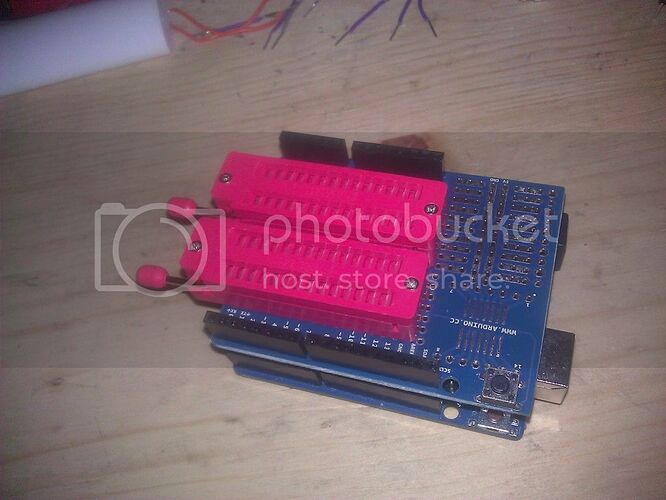

That's what I was planning on doing when I ran into this project. I even picked up an Arduino protoshield and a few ZIF's for the project. I then learned that you can't upload sketches to a bare 328 without removing the chip in the Arduino. I've been looking at a way of making a shield that will allow burning the bootloader and uploading a sketch without a bunch of fiddling.
I should probably just get a dedicated programmer or cable.
But it's something I was sort of, a little bit, thinking about. Maybe 28 pins from the protoshield running down to the chip socket from one of the ZIFs for normal Arduino operation and burning bootloaders to a bare chip which would be mounted in the 2n'd ZIF. Then for uploading sketches you could just remove the "normal" chip and load directly to the other (Abnormal?) one.
I know that the wiring is different when burning the bootloader vs uploading sketches so that could make it un workable.
Any input on this or is it the dumbest post ever
I thought about mounting a ZIF on the board in place of the holder but you'd still be stuck pulling the shield, pulling the chip/ reverse, etc everytime you wanted to burn a chip.
