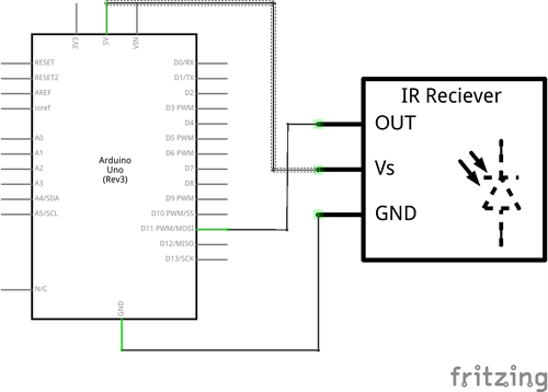

My serial monitor does not respond to IR remote signal...
This is the circuit I made

What I want to do is to print out hex signals that are sent from the remote control I have,
and the problem is nothing happens on the serial monitor.

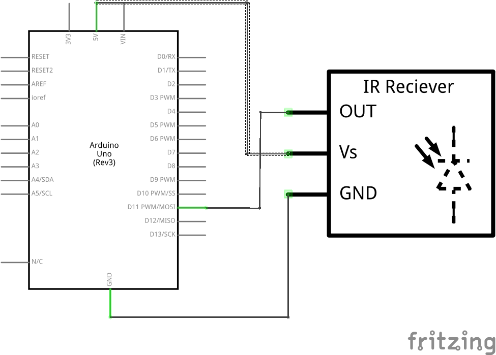

I have two types of IR receivers

You would get more help if you didn't cross post, if you read the rules and posted the code correctly and gave the receiver's part number instead of a stupid mechanical drawing of it.
Also an IR remote does not send hex characters as such.
Also you should not connect the 5V pin to Vin.

How must we know? Did you use the same schematic as @newc33? If so, why did you short 5V and Vin together?
