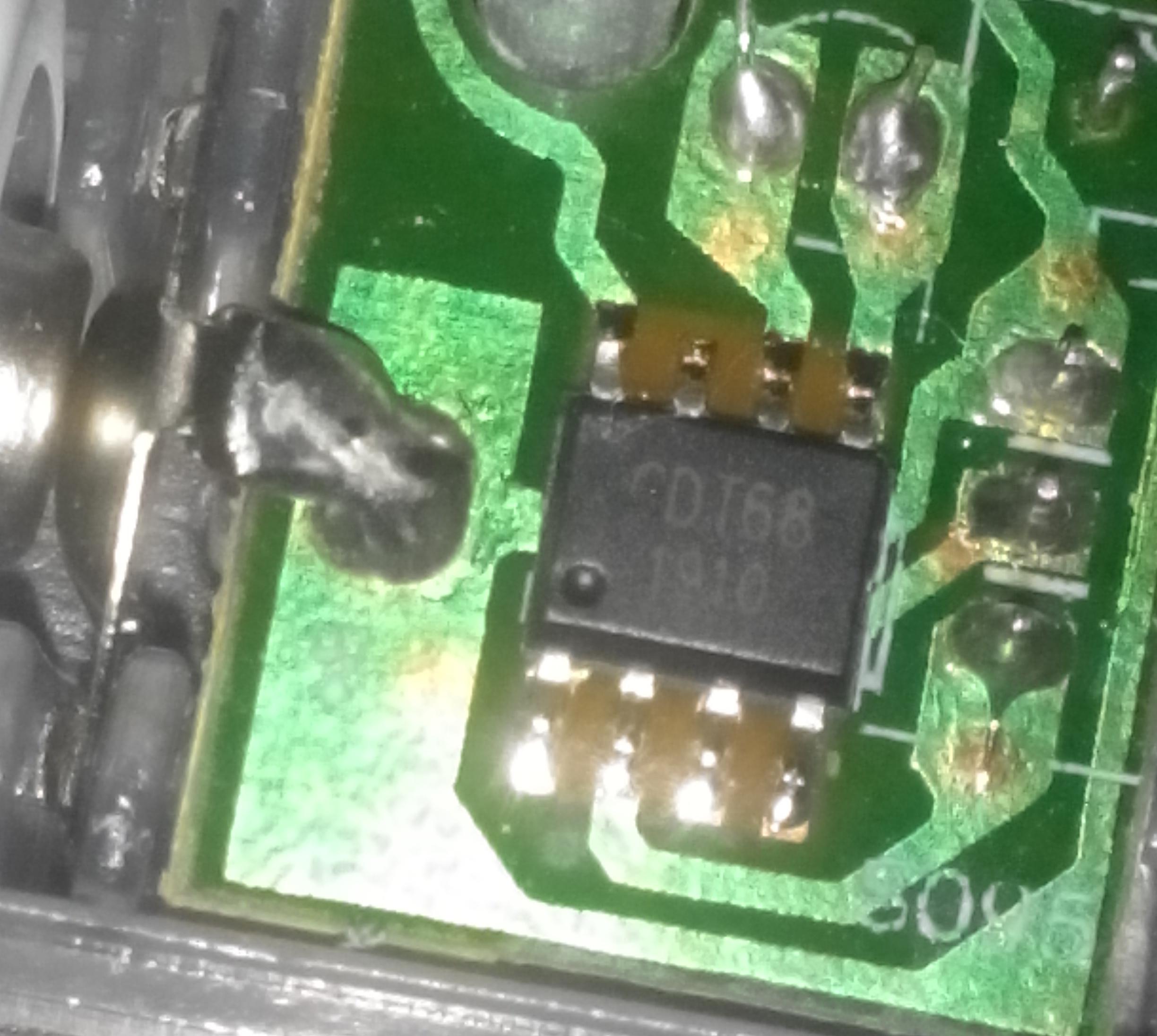

I have got a few cheap Christmas lights. The circuit is trivial - a SOP8 chip, a watch (?) crystal, a switch and 20 LEDs parallel. Powered from 2 AAs. I was surprised the chip is not the epoxy covered blob, and it even have markings: 1st row is GDT68 and the second one is 1910. I tried to Google but found nothing. I think it is a MCU. The pins of the chip are connected in this way:
  1. GND
  2. I/O (?) connected to the switch
  3. I/O (?) connected to another pin of the switch
  4. NC?
  5. XTAL
  6. XTAL
  7. Vcc
  8. LED cathode, it seems simple driver, no constant current something.
Does anyone know what it might be?

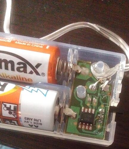

The best photos I managed to capture:
(The first letter seems to be "C" but in direct sunlight it is clearly visible it is "G".)

EDIT2: For convenience I have traced the PCB connections. Yellow are connections to the (watch?) crystal which is in the common round THT package on the other side of the board. The board itself is single sided.

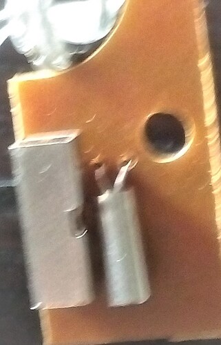

It is a Chinese "toy" for slightly less the $1 (2 AA Alkaline cells included). No LED driver included. At 3V supply voltage the whole circuit consumes 13 mA from batteries. At 2.7V it consumes only 3.6 mA. At 2.5 V only 0.2 mA. Expected values for a while LED. If the circuit were a step up voltage converter supply current should increase with decreasing voltage. Also resistance of the crystal is very high - it cannot be a coil. There is picture of the other side of the board showing crystal:

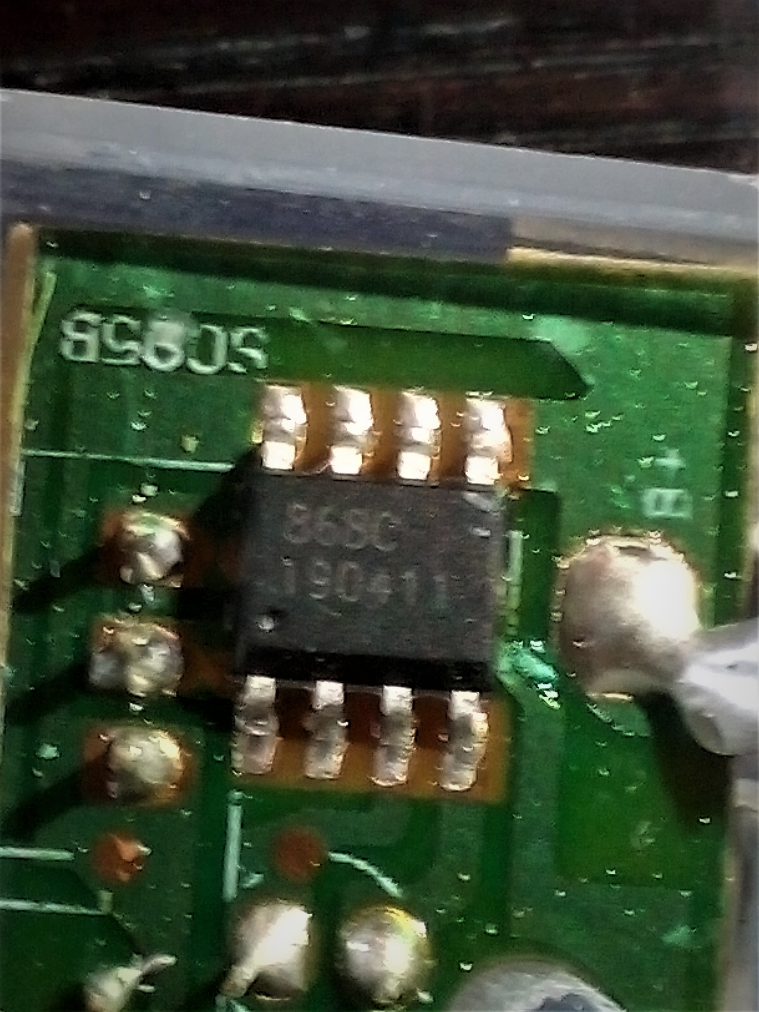

I have looked into other light. 4 of the have the same chip but the 5th has another one. The markings are 868C in the top row and 190411 in the bottom row. The other components and component placement is the same (but the chip is rotated by 180°) but it has a different pinout - the traces on the PCB are different. Functionality seems to be the same. Pinout of this chip is:
  1. I/O
  2. I/O
  3. XTAL
  4. XTAL
  5. Vcc
  6. LED driver
  7. NC
  8. GND

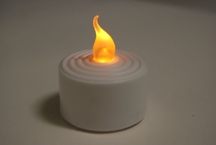

Some "tea lights" (cheap flickering LED lamps) simply reuse music chips from greeting cards.
That works, since musical sound and flickering candles have pseudorandom intensity variations.
