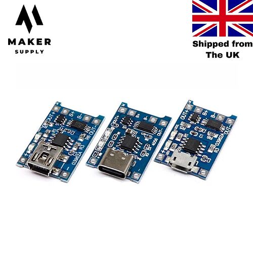

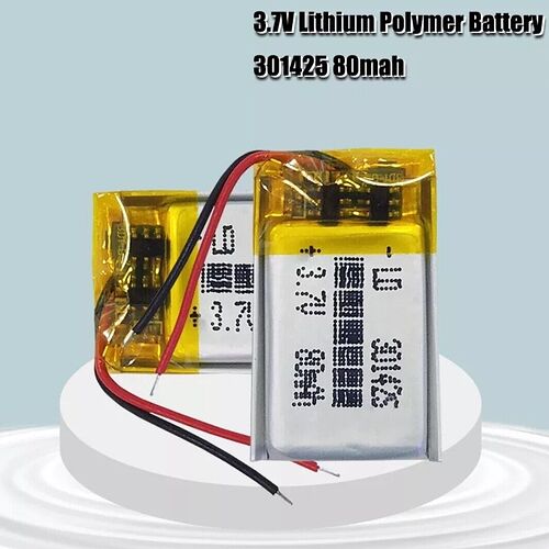

Does your li-po battery have a built-in over-discharge protection circuit? Many do, but maybe the smaller batteries don't, I'm not sure. If not, does your tp4056 module have over-discharge protection circuit? Some do and some don't. If you are not sure, post a link to the specs/product page of the battery and tp4056, or photos, and the forum can probably tell you.
You will need a boost converter to boost the 3.7V to 5V for the Nano 33BLE
Most 4056 boards are only battery chargers.
Here is a really tiny li-po battery, only 80mAh, and you can see it's over-discharge protection circuit through the yellow tape. Hopefully your battery also has this.
Here is the type of tp4056 module that does not have over-discharge protection. You can see only one 8-pin chip on the board. This type is suitable for charging and will protect the battery from over-charging, bit not from over-discharging.
Here is the type of tp4056 which does have over-discharge protection. You can see it has extra chips.
If your battery has over-discharge protection built-in, you don't need the tp4056 module which has over-discharge.

as I can see in the Li-Po there is a yellow tape and some kind of tiny board inside of the yellow taped area. In that case I dont tneed TP4056.
And also my TP4056's are containing multiple chips which is related with over-discharge protection.

That is the battery protection circuit.
