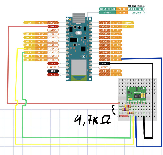

Nano 33 BLE with MAX30100
I'm trying to use the MAX30100 with the ArduinoBLE lib on a nano 33 BLE.
I can use the MAX30100 without any other sensor but when using the ArduinoBLE functionality it stops updating BPM and SpO2 values since beats are not found.
I believe the piece of code that updates the values is not being called fast enough (pox.update()) but I can't upgrade the code to separate the BLE and MAX30100 functionalities.

I'm missing a wiring diagram of your setup. As I assume you use a breakout board for the MAX30100, post a link to it's schematics too! My (wild) guess is a wrong voltage on the I2C bus.
I'm not from electronics background, can you explain why there's a wrong voltage on the I2C bus when I both libs but not when I only use the MAX30100 Sensor?
Where is the link to the schematics of the breakout board you use?
You should change your code to call pox.update() as often as possible and not only if you are connected to BLE.
Yes! That solved it! Thank you so much!!
