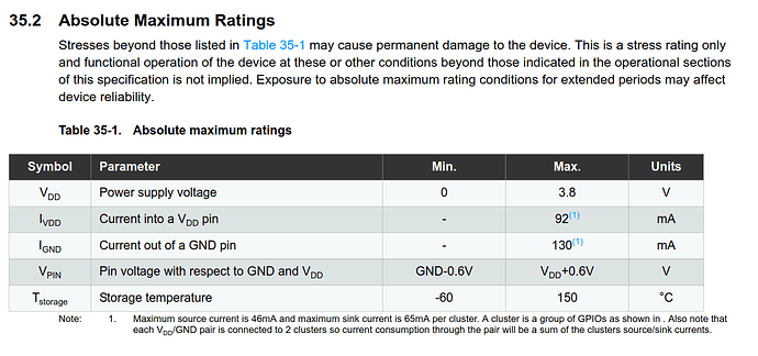

On the USB input side, the D+/D- are directly connected to the PA24/PA25, with a PRTR5V to protect the ESD.
According to the USB standard, the D+/D- are at 5V logic but the ATSAMD11D14A are running fully at 3.3V so the pin logic are also expect to be no more than 3.3+0.6V or it will damage it. (https://ww1.microchip.com/downloads/en/DeviceDoc/Atmel-42363-SAM-D11_Datasheet.pdf)
But in reality, I know all the nano every works, so how and where the magic of the level shifter happened?

By the way, D+/D- are 3.3V level.
Where do you see this?
AFAIK the signal level specs are are 0.0–0.3 V for logical low, and 2.8–3.6 V for logical high level.

  • Low speed (LS) and Full speed (FS) modes use a single data pair, labelled D+ and D−, in half-duplex. Transmitted signal levels are 0.0–0.3 V for logical low, and 2.8–3.6 V for logical high level. The signal lines are not terminated.
@cattledog Thank you for the link, yes, you are right.
