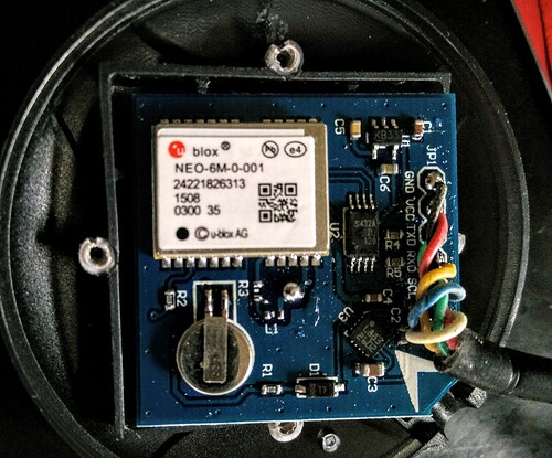

I am using a... NEO M6N GPS.
Are you sure? The NAV-PVT message is only available on NEO 7 and 8, according to the specs. Just curious...

Thanks for the help!
it is definitely a NEO-6M I just opened it up to check. And it is working.

I've been playing with different LED Update Frequencies but have it at 60Hz right now.
static uint32_t lastLEDUpdate;
  const  uint8_t  LED_UPDATE_FREQ   = 60; // Hz
  const  uint8_t  LED_UPDATE_PERIOD = 1000UL/(uint32_t) LED_UPDATE_FREQ; // ms
  static uint8_t  ledUpdateNumber   = LED_UPDATE_FREQ;
The more LEDs I had defined in FastLed, the more issues I ran into with is displaying smoothly. I now have it setup for 3 simultaneous strips of 30 leds each(1.5 meters) which is perfect for my project anyhow.
Thanks again to /dev for all your help with this.
I will continue to update as the project progresses. My 8 year old is excited to get this all mounted on his Crazy Cart!
Demo video here: Arduino Nano NEO M6N GPS OLED Speedometer Controlling WS2812B LED Strips - YouTube
