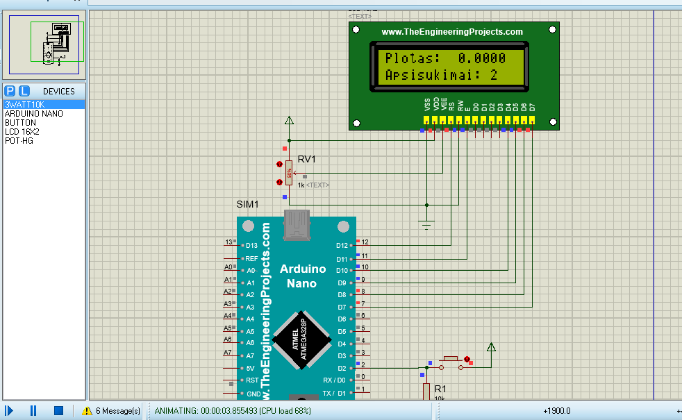

Nano + LCD + Hall sensor. Need help with code.
Hi, I am beginner arduino user. I want to make a project that calculate revolutions. I will use nano + lcd with I2C and hall sensor. Revoliutions I will use in two formulas and the results will be displayed on the screen. I started writing the program and simulating it in the proteus program. Everything is ok with revoliutions. But I do not get another result from formulas. Because my English is poor, so it's hard for me to understand some of the arduino functions. I'm sorry for that.

Your diagram is not complete, where is the hall effect sensor?
Your CAD should be able to export as a jpg file rather using screen capture.
Thanks.. Tom.... :slight_smile:
But code is good? In proteus i am using button like a hall efect sensor.

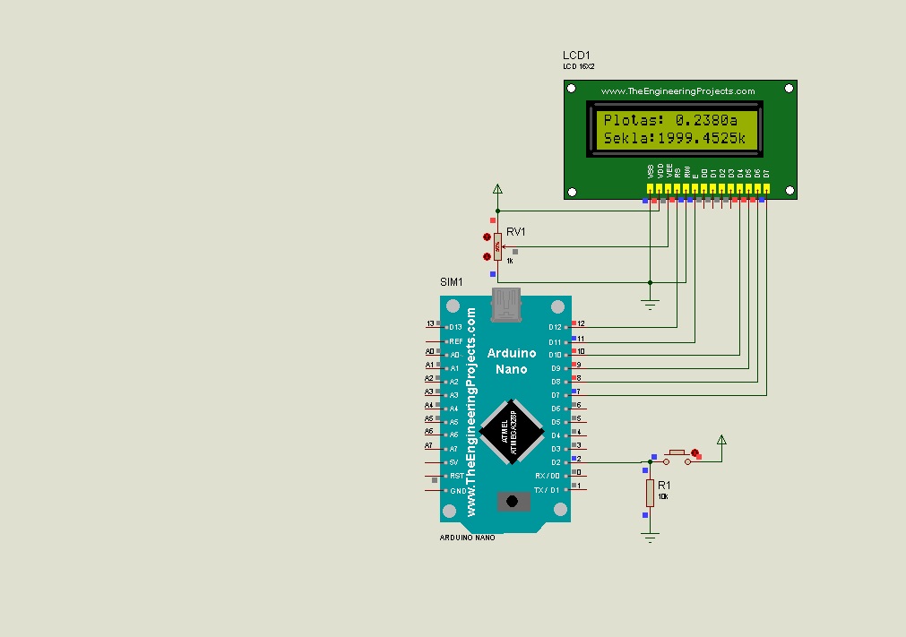

Thanks for reply. Edited code:
