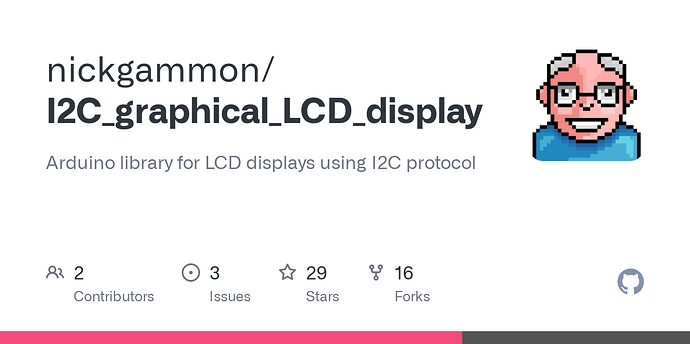

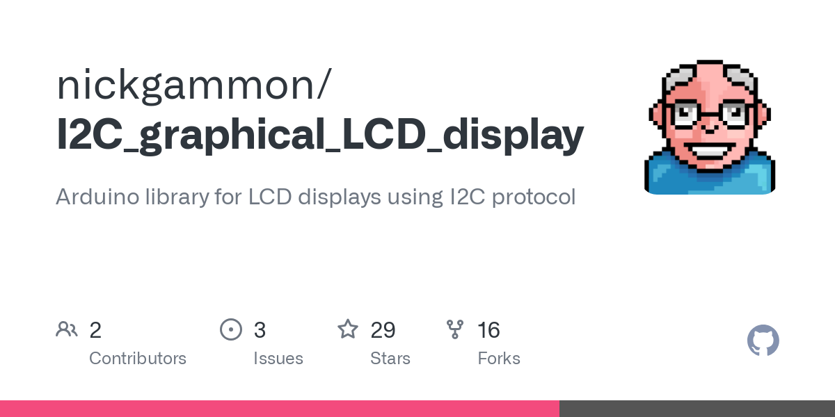

Wrong library. As pointed out, that library is only for use with KS0108 directly connected to Arduino pins.
I have used this one successfully:

Thanks for the tip, I changed the pin configuration in this library for my expander and it worked. :+1:
