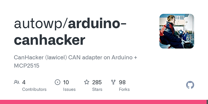

canhacker 2.0 from https://www.mictronics.de/
So I was able to wire it up per the schematic from
I've connected it to the car, configured it per the video, and got tons of "ID's" even though I only have an 2 can bus modules plus the nano combo.

The autowp library has a basic receive demo that displays the Ids and data much like CanHacker.
Modify the mcp2515.setBitrate setting as necessary.
