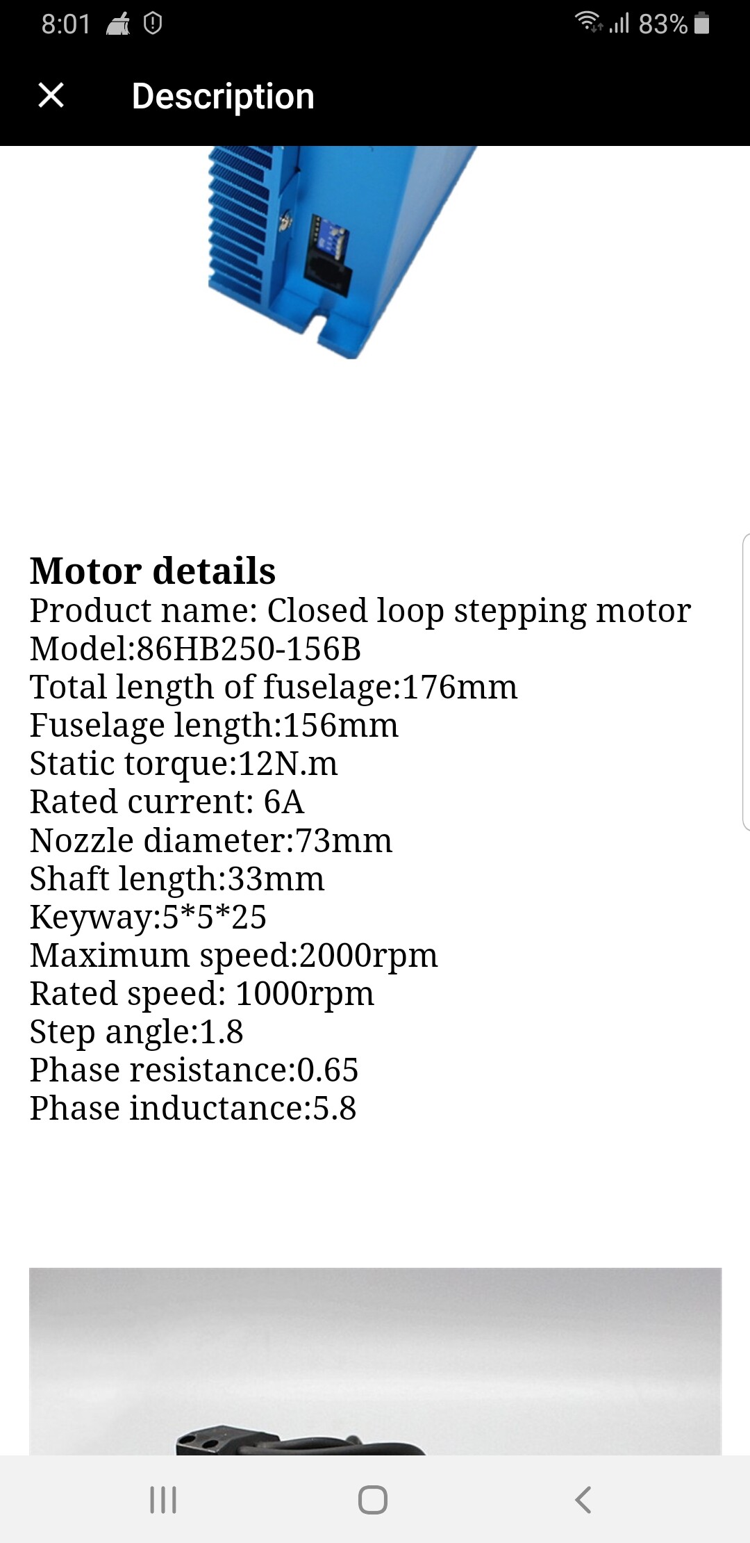

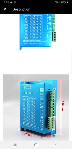

Thanks for reply, the motor description as following:-
Nema 34 12.5N.m Closed Loop Stepper Motor Kit Hybird Servo Driver HB860H + 86HB250-156B 86 2 Phase Stepper Motor
Packing:
  1. 1*1pcs Driver HB860H
  2. 1*1pcs motor 86HB250-156B
  3. 1*1pcs 3M cable
Thanks for reply, the motor description as attachment:-

You were asked for a link to the datasheet or similar. You have not provided that. Instead you copied a few lines out of the sellers description. Then you included some screen shots. That does very little for those of us who want to help you.
Can you give us a link to where you bought this?
Please provide a link to the datasheet or product page for every piece of hardware you refer to, otherwise
we have no clue what it is. A few lines of description are not enough, details always matter.
Also, when you include images please make them visible in your Post. See this Simple Image Posting Guide

As far as I can see the stepper motor in your link comes with a stepper motor driver so there is no need for a RAMPS board. In any case it is a large motor (Nema 34) so it is unlikely that the stepper drivers that fit on a RAMPS board would be powerful enough.
