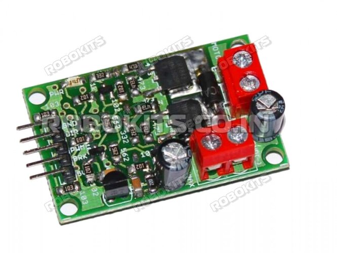

Below are h-bridges you might consider.
I've got one of these.

lowandslow:
Robokitsworld.com
For some reason this link is being blocked by my company's firewalls so I'll have to take a look later from home.
