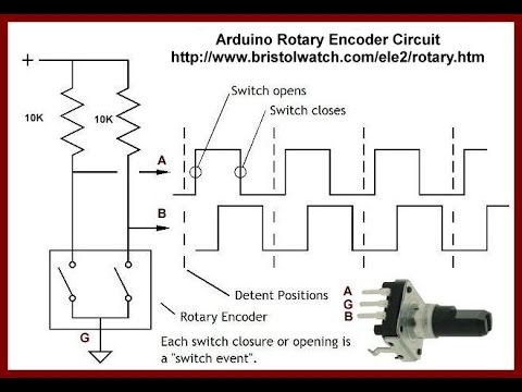

MrBinNZ, Did you ever find a discreet component solution to your project? I need the same info from my encoder. Direction Only. High or Low.
Here is the circuit you need.
The circuit is at 6:04. If you have an optical encoder ignore all to left of 7414 input. Connect encoder A and B to 7414. If your encoder output is clean and short cable you can eliminate the 7414 and go to the CD4013 direct.
