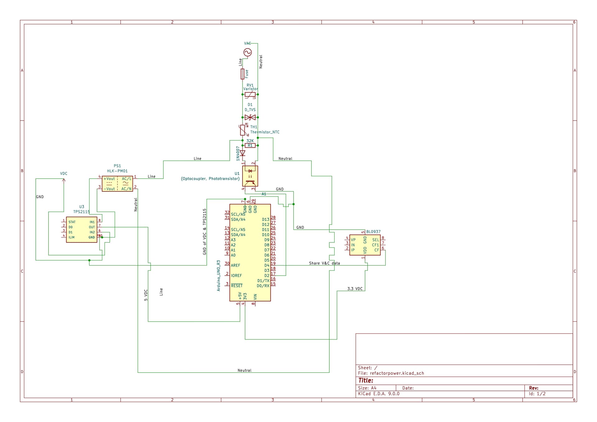

I'm working on a DIY AC mains power monitoring system using Arduino. My setup includes two power supplies:
:one: AC mains
:two: Lead-acid operated sine wave inverter (powers the home during mains failure).
For AC mains failure detection, I'm using an opto-coupler. The protection chain before the opto-coupler includes:
  • Fuse
  • MOV (Metal Oxide Varistor)
  • TVS Diode
  • NTC Thermistor
The AC mains input comes from an outlet without back power (i.e., not connected to the inverter).
To power the Arduino:
  • HLK-PM01 module for converting AC (post-protection circuit) to DC.
  • A second DC source from an AC to DC adapter powered by the inverter.
  • TPS2115 for seamless switching between power sources during failures.
This is my first schematic, so please excuse any mistakes. How can I improve this design? Am I missing any key protections or components?
Your feedback is highly appreciated!

UPDATED SCHEMATIC DIAGRAM (UPDATE 1)
I have corrected many mistakes and errors in the updated schematic diagram. The work on connecting the BL0937 to the Arduino is still pending.
Thank you @jremington, @bobcousins, @DaveX , @TomGeorge, @bluejets for your inputs.
UPDATED SCHEMATIC DIAGRAM (UPDATE 2)

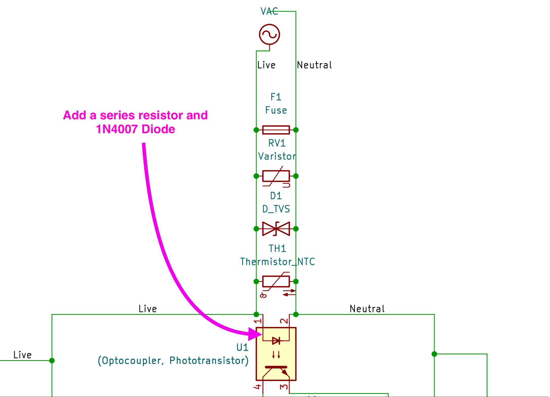

This bit of the circuit will probably pop the circuit breaker in the house, as well as vaporize the optocoupler input, along with significant parts of a PCB. It appears to be a short circuit directly across the line.
You should learn more about circuit theory before even thinking about line powered projects. Or at least use a safety certified wall wart power supply.
For safely monitoring line voltage and current with an Arduino, study this tutorial:
https://docs.openenergymonitor.org/electricity-monitoring/ctac/how-to-build-an-arduino-energy-monitor.html

I hesitate to nitpick style issues after the error noted by @jremington , but there are conventions really worth following like having grounds at the bottom of the page, and power sources towards the top of page. You seem to have a mix of net labels and wires. I would stick to the former.
This part leaves me baffled :
I would also suggest heading over to https://forum.kicad.info/ for lots of good general advice plus advice specific to KiCad.

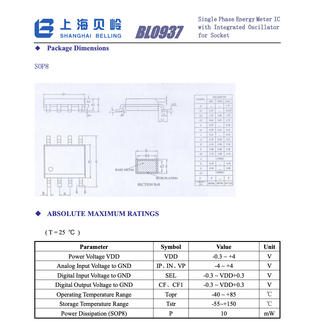

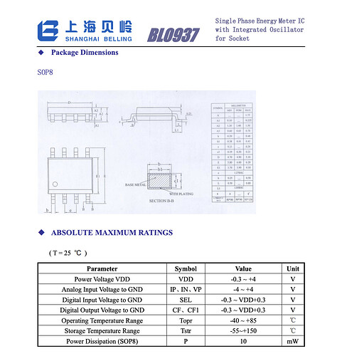

The 4.3V max voltage on the BL0937 IN/IP looks like a potential issue:
Thank you, @jremington, for pointing this out. This is my first time using software to create a schematic, and I truly apologize for any mistakes or misunderstandings on my part.
Is the main issue because I didn’t include a current-limiting resistor for the optocoupler? What else do you think I might be missing?

There are so many serious problems with the posted schematic that it is not worth further discussion.
However, it does reveal how little useful understanding you have of basic circuit principles.
At this early stage, I recommend that you not undertake any project connected to an AC line, as the attempt could be fatal. Stick with battery powered projects and you will learn.

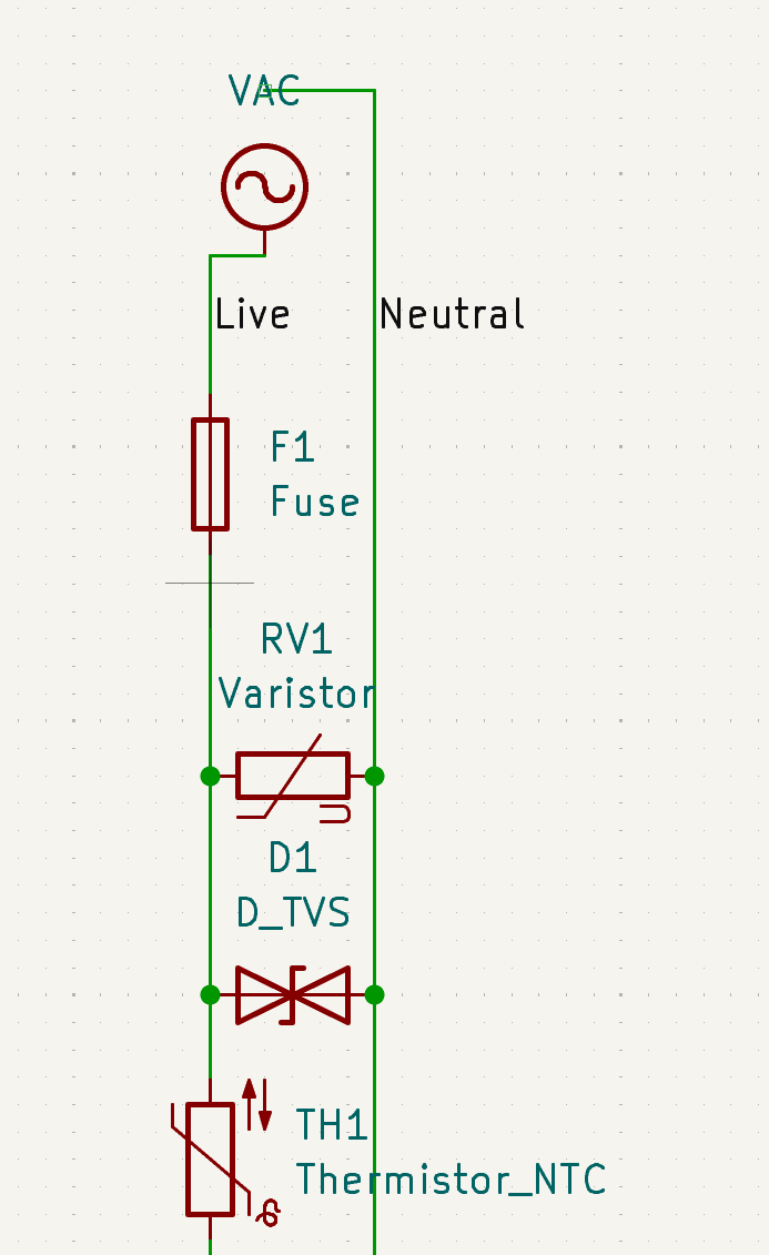

I recommend that you go through the circuit elements one by one and question the purpose of each one, and your placement of each one.
Start with the fuse, which is the very most glaring error.
Good luck with your endeavors.
Holy cow. How can I miss this??? This happens when one does not re-check/verify the work.
Also corrected the placement of NTC thermistor.
  • Also the output of the Opto isn’t connected properly.
  • Time you rethink everything. :sob:
