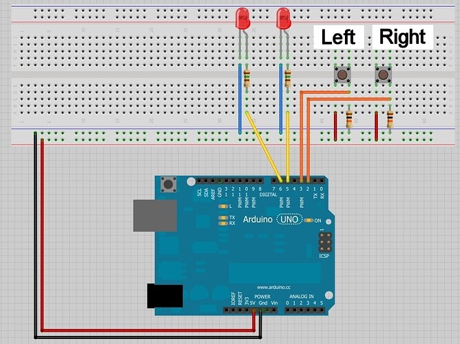

Right button pressed -> Right LED blinking until Right button pressed -> Right LED off
Left button pressed -> Left LED blinking until Left button pressed -> Left LED off
It's blinking, but not turn off
Pls help
Here Code:
int button_right = 2;
int button_left = 3;
int led_right = 5;
int led_left = 6;
int buttonState_right = 0;
int buttonState_left = 0;
pinMode(button_right, INPUT);
pinMode(button_left, INPUT);
pinMode(led_right, OUTPUT);
pinMode(led_left, OUTPUT);
buttonState_right = digitalRead(button_right);
buttonState_left = digitalRead(button_left);
if (buttonState_right == HIGH) // First Right Button pressed
Blinking_right(HIGH);
if (buttonState_right == HIGH) // Second Right Button pressed
while (Blinking_right)
Blinking_right(LOW);
if (buttonState_left == HIGH) // First Left Button pressed
Blinking_left(HIGH);
if (buttonState_left == HIGH) // Second Left Button pressed
while (Blinking_left)
Blinking_left(LOW);
void Blinking_right(boolean right) {
digitalWrite(led_right, HIGH);
delay(300);
digitalWrite(led_right, LOW);
delay(300);
void Blinking_left(boolean left) {
digitalWrite(led_left, HIGH);
delay(300);
digitalWrite(led_left, LOW);
delay(300);
