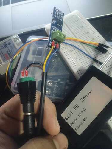

I have a soil pH sensor with rs485 output that is connected to MAX485 and ESP32. I'm having a bit of a problem as the serial monitor doesn't show the correct value (Just random characters that is not supposed to be showing)

i tried using the other inquiry frame from the datasheet and also connecting and disconnecting the pins but it still persists. Any form of criticisms is much appreciated

This is the wiring my soil pH sensor to MAX485
the brown and black wire which is positive and negative respectively are connected to a 12v power supply and the Yellow and Blue which is the A and B is connected into the A and B port of the Max485 (The wires are coated in metal jacket if that helps)

Some observations that may help you:
As already mentioned, you need 2 separate serial ports - 1 to handle your Serial.print output and another to communicate with your RS485 sensor.
The datasheet indicates that the default baud rate is 9600 baud (see section 3.1).
You need to be careful in your handling of the RE & DE signals. Generally RE & DE operate as a pair - either both LOW (receive) or both HIGH (transmit). If you only drive DE HIGH (and keep RE LOW) when transmitting, then your receiver will hear its own transmission which you will need to ignore. This doesn't happen if you also drive RE HIGH when transmitting.
You are on the right track here. However, using a delay like this can lead to the transmission being cut short or the transceiver still being in transmit mode when the remote device tries to respond. Have a look at Serial.flush() rather than using delay().
The response from the sensor consists of a Modbus reply message. See the response frame in section 3.4 where you will see a 7 byte response and the location of the pH value in that response.
