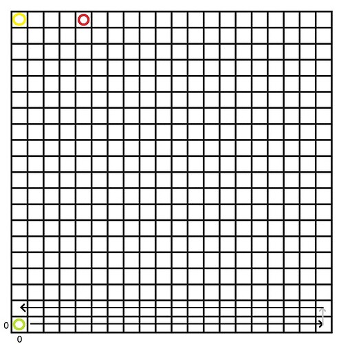

My issue that I need help with is, I have 2 nema 17 motor attached to the adafruit motorshield v2 which is connected to an arduino uno. I am using matlab to control the stepper to move in a grid like pattern. A 20 by 20 grid, where 0,0 is its origin. The setup that I have does what I want it to do, raster scanning using a carriage with a sensor attached, where one stepper controls the x axis and the other the y axis.

At the end of the grid, the position of the stepper should be at 0,20, however i an having an issue where throughout the scan each row going upwards the x axis is some how being displaced. So instead of the final position being 0,20, it is at something like 4,20 on the grid.

The image above illustrates the issue that i am attempting to fix. The green circle is my origin, the beginning of my scan and the red is the end position of the scan. I am trying to understand why the end position is not at the yellow circle but instead at the red circle.

Yes, that's where the motorshield came from, too. Anyway, this won't help you. You need a defined acceleration/deceleration or you loose steps. Now you have infinite acceleration/deceleration - that will never work. You can decrease speed to a crawl, that might look as if it works for a while, but that's an illusion.
Oh, before you try to implement acceleration/deceleration in Matlab: that won't work, either. You need realtime control of the stepper driver.

Update: I've looked through the MATLAB files for the functions used and no mention of acceleration or deceleration. Also looked into the .h file for the Arduino motor shield that is programmed to the Arduino and there is also no mention of acceleration or deceleration.
Also, to sum this up, based on the image that I uploaded previously, the reason I am having the issue that i am having is due to not being able to define a set value for acc/deceleration? Would this assumption be correct to explain the problem in the picture?
Kind of. But why can't you just send out gcode to /dev/ttyACM0 (or what ever is your serial port)? just your "move(12,130)" would send send "g1 x12 y130" ?
