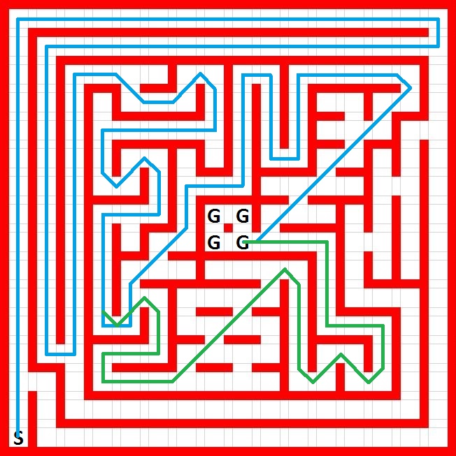

Usually the destination is at the centre of the maze and there is often a post in the centre with no adjoining walls, like this:
I am not sure how the robot will know it had reached the centre. Possibly by dead-recconing it's position from the starting point at the corner. Possibly by recognising that the post has no adjacent walls. You will have to research and experiment.
