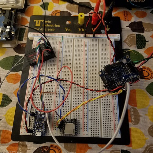

Need help integrating an RC receiver to an Arduino Uno
I seeking advice on the sketch type I should use. I don't mind doing the research but have been having some problems finding the correct advice.
What I am trying to do is use existing free RC channels (4 ea) PWM output to an Arduino Uno.
I then need the Uno to communicate via serial tx rx to a DFplayer Mini. A mp3 player module needs to change between audio tracks and other available functions. (Two PWM channels) #1 channel 3 position switch to select files. #2 channel 2 position switch normally off repete last track.
I also need the Uno to communicate via 12C to an Adafruit 20W amp board to change the vol and to mute. (One PWM channel) 3 position switch Mute/Medium vol./Max vol.
I will also need to activate an Arduino compatible relay to operate a light. (One PWM channel) 2 position switch On/Off.
Ultimately the finished code will be inserted to an Adafruit Pro Trinket Mini that will operate amp board and mp3 player.
I am pretty new at writing sketches as I've been able to use examples until now to get by.
I'll do my best to research, write, and test but can someone suggest a set of library's and different Arduino modes that need to be utilized.
The reason for using RC reciever PWM out to microprocessor is it will be used on a drone.
I the PWM signals are only needed one way out to microprocessor.
Microprocessor then needs to communicate via serial tx/rx to DFPlayer mini and 12C to Amp board.
So would I be able to hook 4 wires plus ground up from RC reciever to microprocessor?
Then be able to distinguish between 2 or 3 PWM signal's value per channel?
Then send appropriate one way data to other boards via 2 different data types?
I actually have this already wired up to a breadboard ready to code. Just need to hook up the reciever to the proper Uno pins to start.
I can add a pic of the prototype if neede?
Can anyone help on such a project?
Any help is very apperciated!

pulsein() gives you the pulse length of the PWM/servo signal. If your RC channel is has an analog control (gimbal or knob) you will see a wide range of varying lengths. A 3-position switch will give pulse lengths something like 1ms, 1.5ms or 2ms. Your code can then interpret these values. It's been done many times.
Steve
briefly, however, it looks like this limits to either high or low
Incorrect, pulseIn() measures the length(width) of the pulse in microseconds. it does not return HIGH or LOW.
I understand that it may be too difficult to expect Arduino IDE pulseIn() to see 3 different PWMs?
Keep researching, pulseIn() can do this easily.

Connect to 4 digital inputs and start by just doing pulsein()s and printing the results so you know exactly what values you get.
E.g. see this tutorial.

Awesome! Thanks. I finally hooked up my reciever and now have a PWM readout (range) for 4 different channels.
I have written down the PWM range with the sticks centered and written down the PWM range with the sticks manipulated.
Now I have to learn how to write the code to activate a sunfounder relay to turn on a light.
(Have it all wired up to pin #7)
I then have to write the code for the amp board to mute/50%/100% volume with I2C comm.
Also have to add code to change file on a DFPlayerMini with UART TX/RX
Finally one more command to play last track played on a DFPlayerMini UART TX/RX.
Not sure how to write these extra commands to an existing code that I've been working on.
