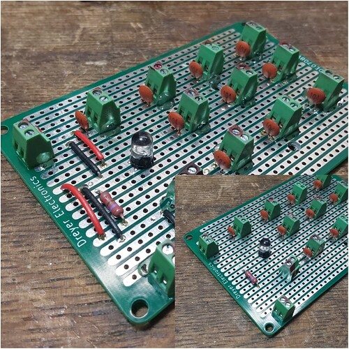

Mega 2560 with terminal shield and roll your own Power Distribution Board:
PDB detail
