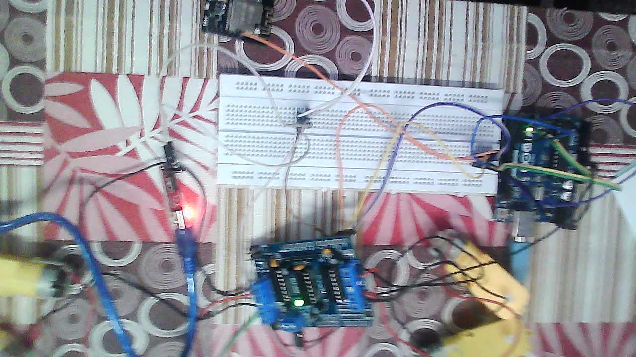

Need Help Making RC Car with ESP8266 and Arduino Uno
The motor shield uses pins D3 through D13 inclusive.
So you can't use 10 and 11 for serial
You can use any of the analog pins A0-A5

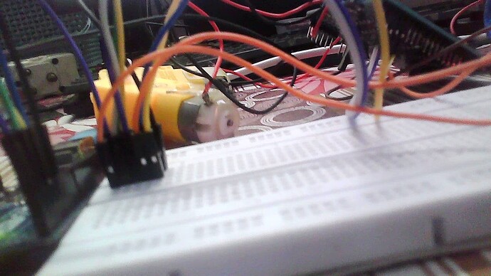

OK. How are your code and circuit behaving now? Are you being able to send commands to the ESP from the web server?
that was always working, but yeah my whole project is working now xcpt the motors who for some reason are not turning after being told to
Don't need it anymore just connected to 0, also I have not put the shield directly on top
I will send circuit diagram picture in some time
Please measure the battery voltage. Maybe the battery charge is down.
no it is sufficient
{I'm downloading Fritzing so this is temporary}
That may be your whole problem. It uses many of the Uno pins that you may not be aware of.
Its working, I just had to put the sheild on top of it and sholder the tx of esp onto pin 0. Thanks for your help guys, but don't close the thread as I am also going to make a drone with the esp
Yeah, we were thinking about that from the start of this project, but we weren't sure how to connect the esp once screen is on top, so I just put the jumper wire on the pin(I don't have soldering materials), and was like was the worst that could happen, and it worked
You can still use software serial to sendto and receive from the ESP if you want, just don't use pins D3-D13
Glad it's finally working.
Have fun!
D3 - D13? on the esp or the arduino?
Arduino. The motor shield uses those pins
Ok, thanks!
