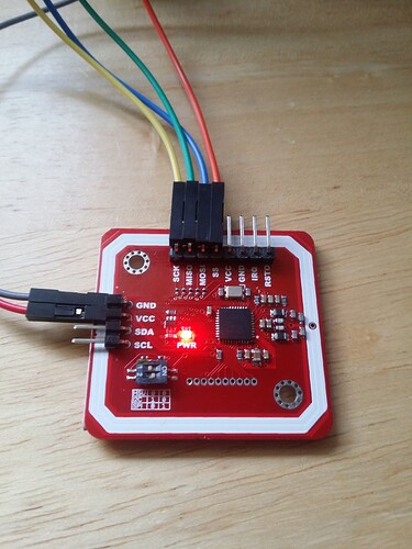

hello, i just purchased of these NFC module (PN532 NFC RFID module V3 kits -- NFC with Android phone) and i am trying to get it to work and it looks like the sketch provided has problems.

i did download the libraries that you guys provided in the manual
I think you are confused as to who you are writing to. You need to post a link to where you got the library you are using.
I finally got it working but in a different wa, with a different library.
I have it connected to arduino uno like this:
SCk -> 13
MOSI -> 11
SS -> 10
MISO -> 12
NFC shield: http://www.elecfreaks.com/store/rfidnfc-shield-shdnfc-p-479.html
