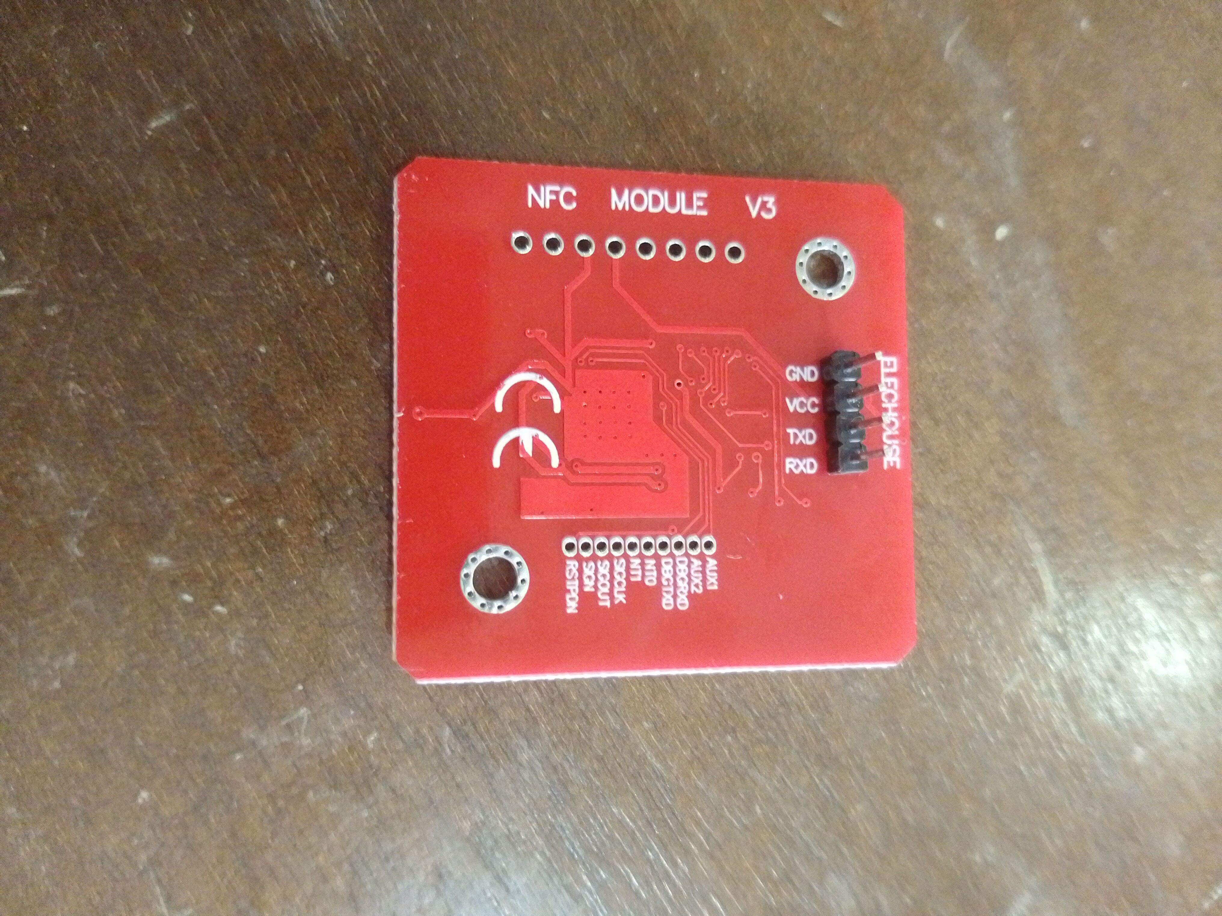

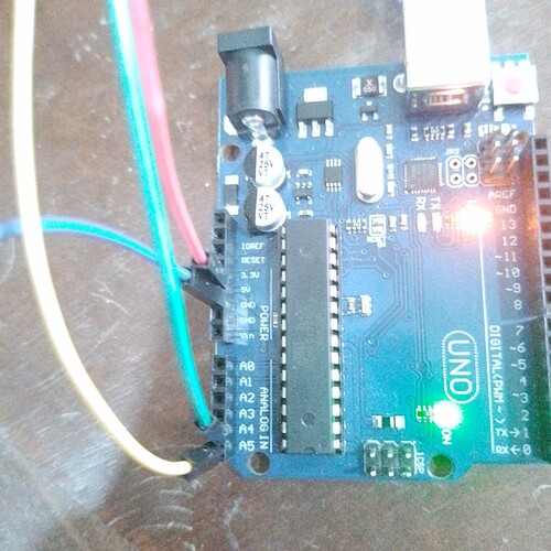

Here are the details of my setup:
Arduino Uno          PN532 Module
   GND  ------------ GND
   5V   ------------ VCC
   A4   ------------ SDA
   A5   ------------ SCL
Additional Information:
  • I have checked the wiring multiple times.
  • The PN532 module is set to I2C mode.
If anyone has experience with the PN532 module or can provide guidance on troubleshooting this issue, I would greatly appreciate your help!

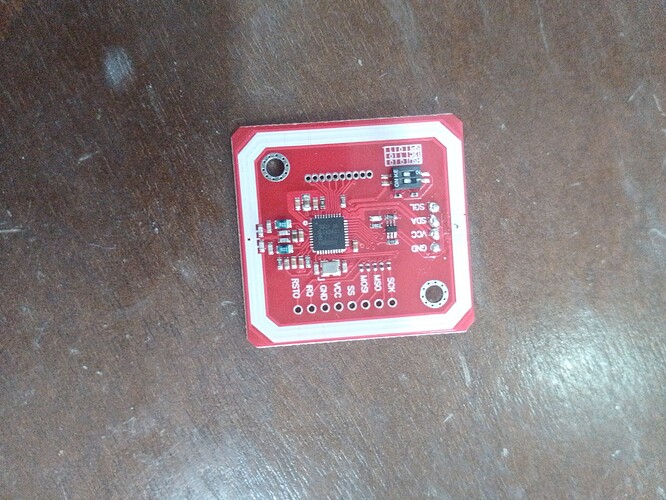

That soldering looks suspect to me. You could well have a short between Vcc and SDA, and I'm not sanguine about that GND connection at all.
And likely more importantly, those switches do not appear to be in the proper positions to enable I2C to me.
Indeed.
To me too.
Thank you to everyone who took the time to respond and sorry for wasting your time . How foolish i was , the problem were in switch part :]
