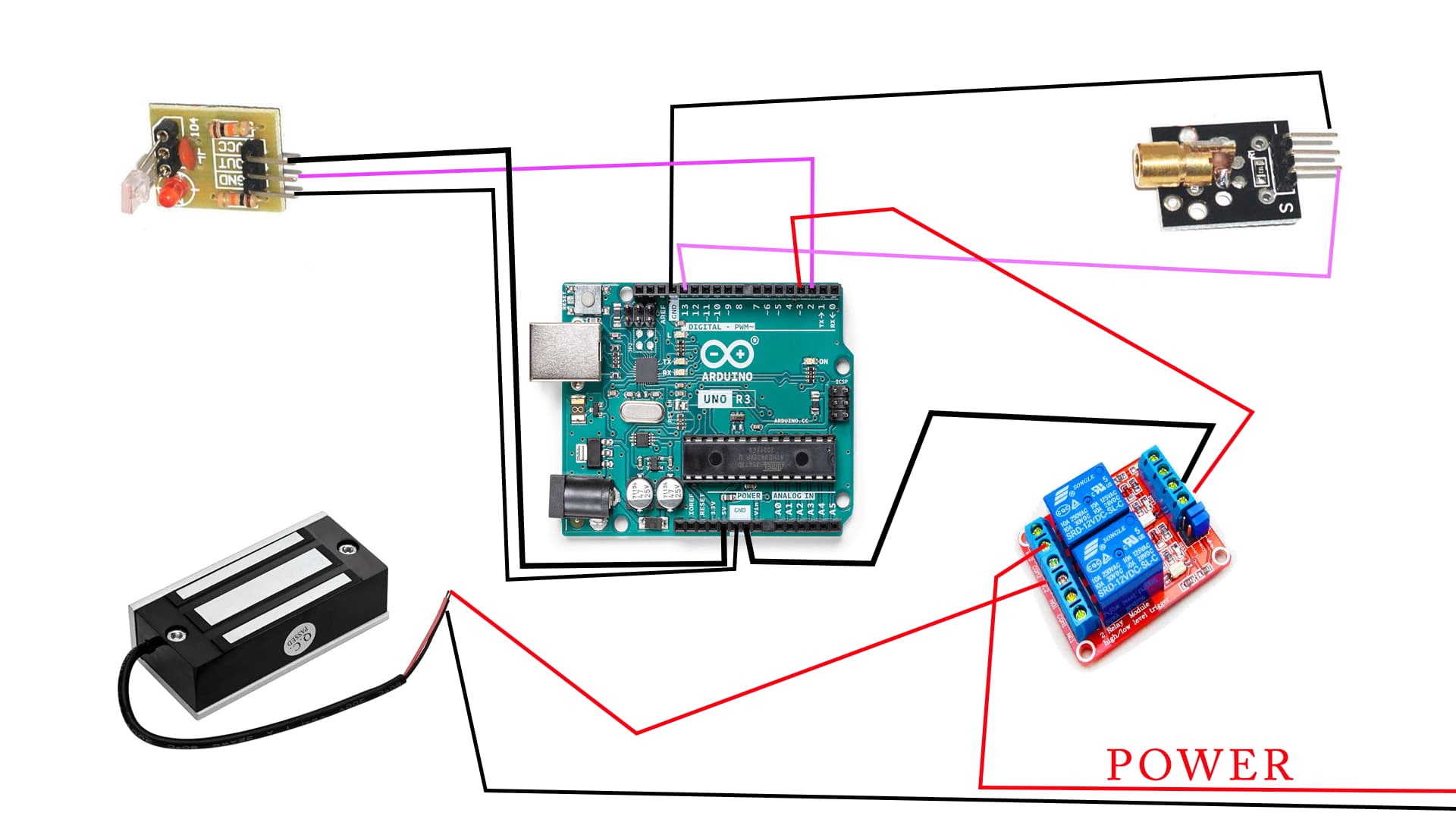

If you bought parts you must have a proposed schematic.
Here is what I have so far. Haven't connected the other side of the relay yet, this is kind of where Im at
Looks reasonable.
Try the IDE examples for input and output sketches.
The mag lock you will need a kickback diode.
The relay inputs need connecting.
Something like this? Where can I find the input output sketches?
Need to see the relay module input requirements, you will need a relay coil power supply too.
