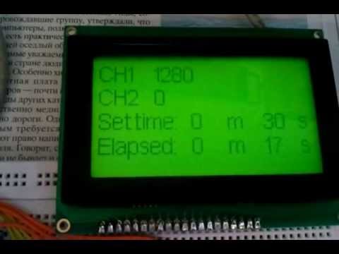

Hello. I need to make an impuls counter. So, earlier I solve the same task using inteprrupts. If its intersting, here is a demo videos:
and
Now I have to use something with more frequency. So, i know that ATMega has 3 timers. (one is using for delay). Please, help me to understand how to use them in "counter" mode. May be you have some examples, projects or tutorials. anithing for arduino.
