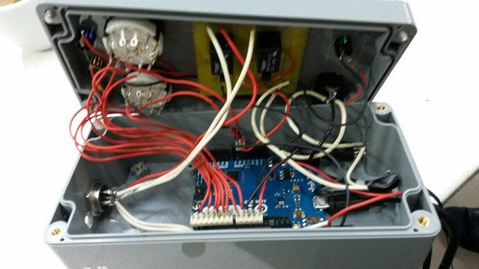

i finally finished the project. i used an Arduino Leonardo, 2 rotary switches, and a custom made board for 2 relays, a 24DC relay.
- multiple position rotary switches for setting the number of steps in each mode, photo1.
- board with 2 relays since i couldn't find a single relay with 3 positions. i used 2 to give me closed circuit for each position of the switch on the press that controls in which mode the press operates, photo 2.
- 24DC relay for giving input to arduino whenever the press is on up/ready position.
i have set up the arduino to use the INPUT_PULLUP method on all inputs so on integer level i read 0 for LOW, and 1 for HIGH. as explained here constants - Arduino Reference . i found this method to be very simple since i can keep the things simple and just send ground to each pin that i want to read input.
sorry for not preparing in detail on the DIY. i think that the information provided will provide the necessary explanation on how the solution worked out. when i have time i will be preparing a step-by-step DIY and post it.

const int buttonPin = 12; //the input to read the position of the press
const int ledPin = 13; //test led
const int s = 10; //relay to position mode
const int p = 11; //relay to pressure mode
