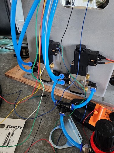

Post a timing diagram to see what shall happens and a picture of the hardware setup.

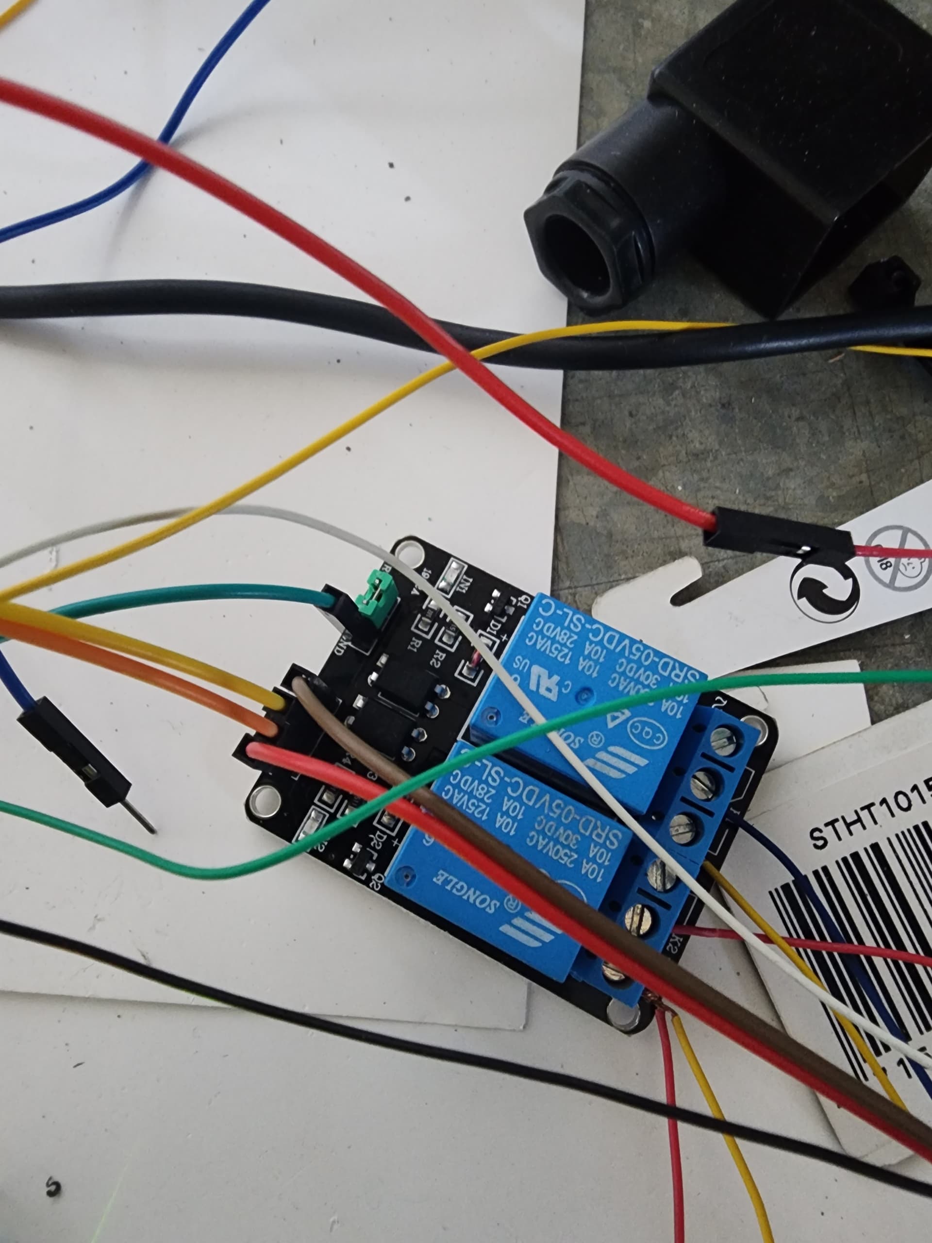

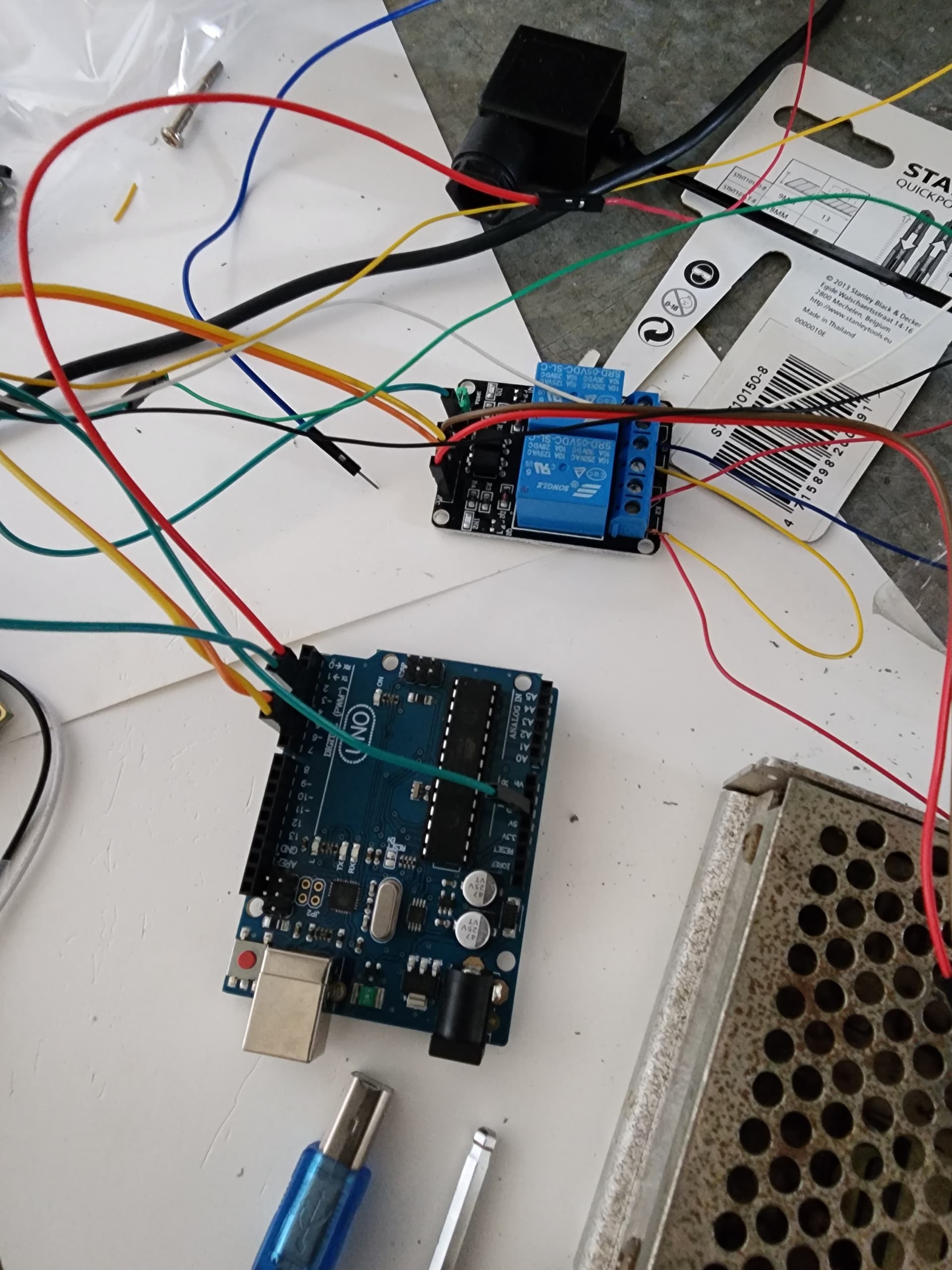

Thank you, i have uploaded the code but its not doing anything, i see you have allocated pin 6 and 7 to limit swit hes, how do i now add in the pins for the cylinders?
What are the elecrical connections for the cylinders?
I basically need the code added to control the moment of the cylinders
This what chat gpt says
I know nothing about your cylinders or how to move them
Iasked chat gpt to add in the cylinder movements and this what it created, does this look right?
Arduino cannot directly drive valves, what is the valve's voltage (AC or DC) and current rating? Which Arduino output pins are switching the valves?

Hi, @jordysteinbach
Have you written code JUST to prove you have control of your cyclinders?
